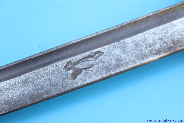

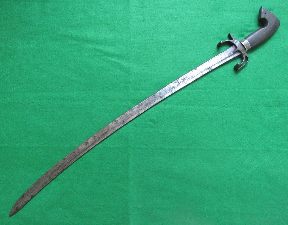

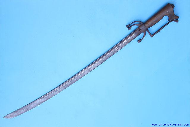

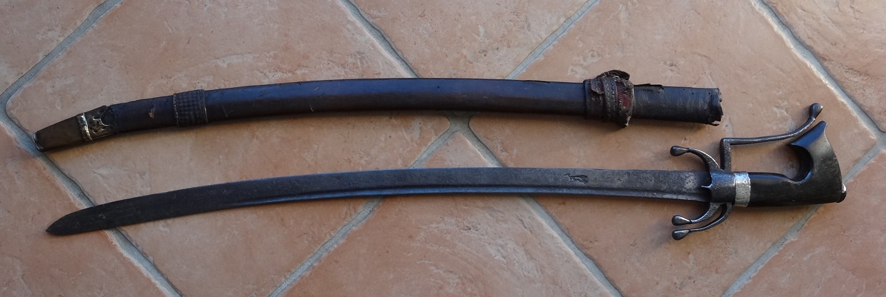

Here is a Moroccan Saif, or what we as collectors commonly refer to as "nimcha". The blade might actually fall loosely into the "nimcha" category, as it is 27.25 inches long (69 cm) and based on the fox markings stamped on both sides, it probably originated as a British hanger or cutlass.

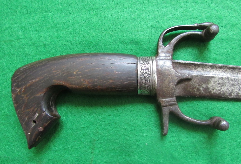

The guard is also interesting, as it is of the type with the two inner quillons bent at a 90 degree angle to the blade, as opposed to running parallel to it. I found a similarly marked Moroccan sword in Oriental Arms Sold Items archive, with the more common guard form. Also, the fox on the one sold by Oriental Arms is running in the opposite direction.
Teodor

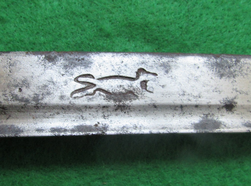

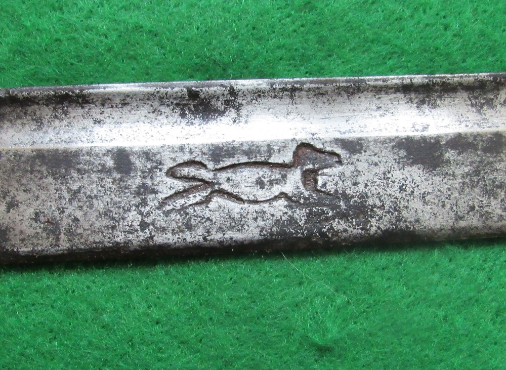

Interesting to see a British blade in one of these, though they are certainly known in this context. Actually this appears to be the 'fox' mark used in England as opposed to the 'running wolf' mark famed in German blades.
The 'fox' was used in England originally in the Shotley Bridge works near Durham in the north in the late 17th c., and in response to the German wolf used earlier in the century with German smiths at Hounslow outside of London.
In this case, the blade appears 18th century, and may be one applied in Birmingham c.1750s. Usually these bushy tail fox marks have the initials SH for Samuel Harvey, but it is known that another maker, Dawes, also used the fox but probably these were blank.
There was notable trade by England with Morocco in the 17th century, and there are instances of English merchants wearing 'nimcha'. Whether this might be one such example, or a blade which ended up in the Moroccan context would be hard to say, but the connection is clear.
** see currently running thread on Shotley Bridge for more on these marks.

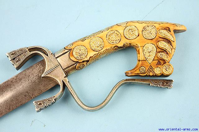

The side langets bent to form a circle perpendicular to the blade are characteristic of Omani “Zanzibar” saifs.
The greatest majority of Moroccan saifs ( “nimchas”) sport trade european blades. Thus, I do not find it unusual to see a British one. I think we even saw here a Moroccan Koummya ( a very peculiar blade!) with British marks. My guess only Flyssas were always local.

I too am wondering about the reason for the unusual quillons bent perpendicularly to the blade. The hilt is most certainly Maghrebi: the form of the grip and the decoration of the white metal band under the guard are Moroccan in style. Could this have some chronological (earlier vs. later style) or geographical significance, or could it be a vestige from hilts with D-ring guards like those from Zanzibar? While less common, we have seen this type of guard before, like for example on the much higher quality sword posted by Tatyana in the link below:

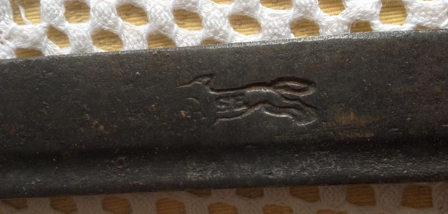

Yes you are right.

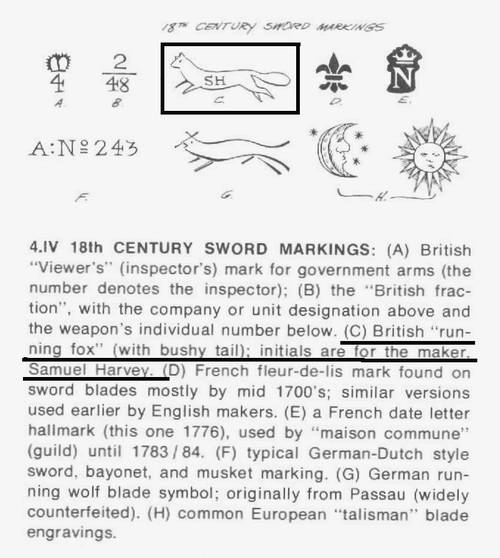

Here is another one from the 18th c. with the SH fox.
Kubur
Old 23rd November 2017, 03:07 AM   #7
Posts: 10,872
Excellent Kubur!!! Thank you, here is the more well known fox from Birmingham with SH (Samuel Harvey) and thank you for the entry in the panel of markings.
* excellent note on the fluer de lis used in England as well! Is this from Gilkerson?
The fox without initials as I noted is in my opinion for John Dawes of Birmingham, but he did not initial his.

Thank you for your notes. To make matters complicated, I believe there is a distinct version of these hilts that was used in Zanzibar and the Omani Eastern African possessions. In fact, on p. 237 of his book, Hales shows a photograph of the Vizier of the Comoros (not formally part of the Omani Empire, but under heavy Omani influence via Zanzibar) where the Vizier's guards have swords with hilts like the one I am attaching from Oriental Arms sold archive.
I believe that in other threads it has been shown that the version with two of the quillons forming a D-ring is also Omani/Zanzibari. If you look at hilt form alone, there is also similarity to saifs from Southern Yemen, many of which may have been produced all the way in India and exported to Yemen.
There is a connection, somehow, between these hilts from opposite costs of Africa, but it might be better served in another thread.

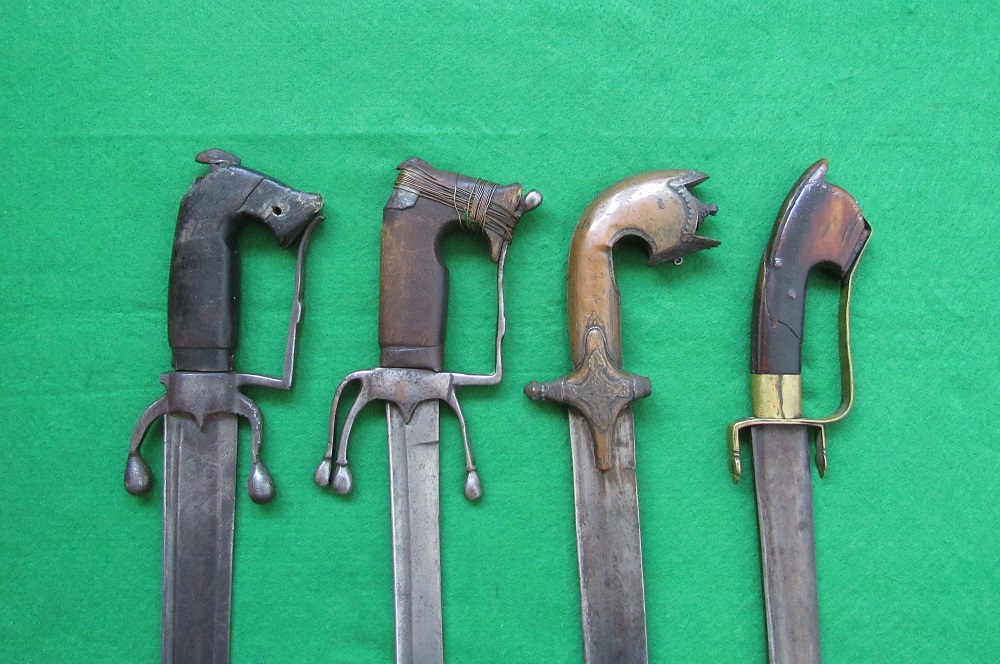

A.http://www.vikingsword.com/vb/showth...ghlight=nimcha
Great thread... very much in support of the various threads on Moroccan Saif and on the Shotley and other centres in England. ...However~ It is my view that a lot of this is in fact still being penciled into the margin for example; the SH inside the bushy tail fox is Samuel Harvey either Snr or Jnr of Birmingham. The Shotley Bridge wolf mark is either a copy of the Solingen/ Passau mark on imported Solingen blades or was struck by the German sword makers at Shotley Bridge. There is some conjecture as to Hounslow using the bushy tail fox and other sword makers but it is still unfurling...
The Moroccan saif was used by English military Bands of London e.g.Tobias Blose is painted
carrying one (Ref A) thus these English blades were seen on Moroccan hilts.
If these blades were being brought into North Africa I see no reason why they could not have been used as many blades came flooding in on the trade blade route.
The Piton guard on TVVs first at #1 is Moroccan. The hilt above with a formal cross guard and turned down pommel had a chain guard still showing the pin on the pommel where it was attached. ...and three pronged top to the pommel more in fashion with the Red Sea Saudia variant ..Reference A. Refers.
One key indicator is the peened spigot on top of the pommel which on Zanzibari weapons looks like a turtle. Usually on other types it is a simple round stud; occasionally decorated.

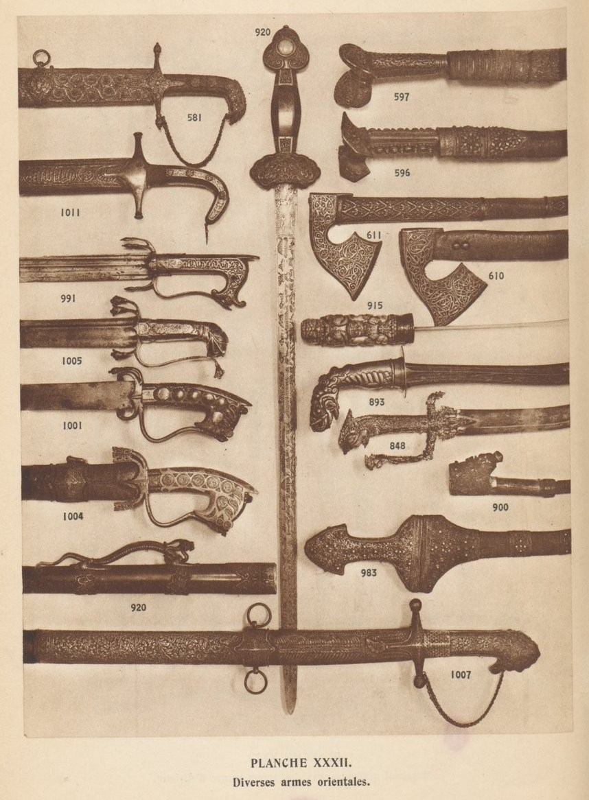

In his article Les poignards et les sabres marocains (in revue Hespéris XXVI, 1939, pp 1-28 & plates I-X), Buttin makes the following statements:
The pitones, and the D ring serve as protection for the hand against a blow sliding down the flat of the blade. The former are a Spanish influence on Moroccan sabres and a rare occurance, while the latter is even rarer, but not unusual in the Arab variant.
He makes a clear distinction between Maghrebis and Arabs from the Peninsula.
This type of sabre came to the Maghreb with the conquest of North Africa by the Arabs.
The Maghrebi hilt retains the form of early Arab examples.
He goes on to describe at length the differences between Maghrebi and Arab hilts.

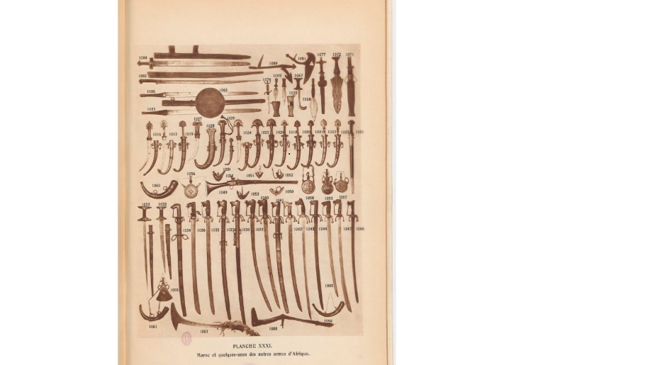

Butin was not only and excellent weapons author but lived in Morocco. It can be seen that he named these charts carefully...
1.One is Moroccan.and other African arms.
2.The other is Arabian...
3.The Third is other Oriental variants.
Both structure and blade size are comparable in each chart.
He produced accurate charts viz;
