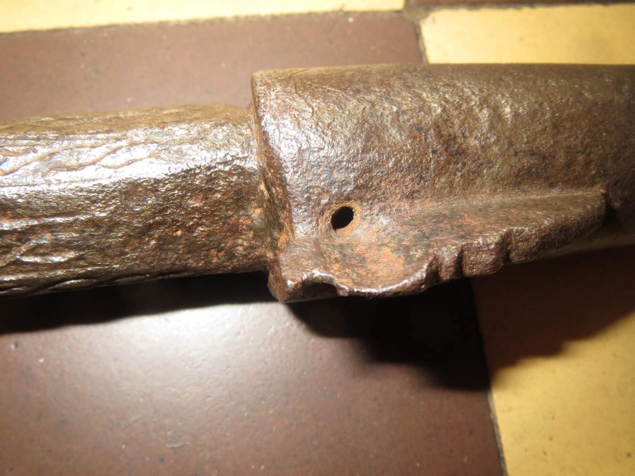

Not sure if this is ethnographic but I had to make a choice. Bought it at an auction last week.

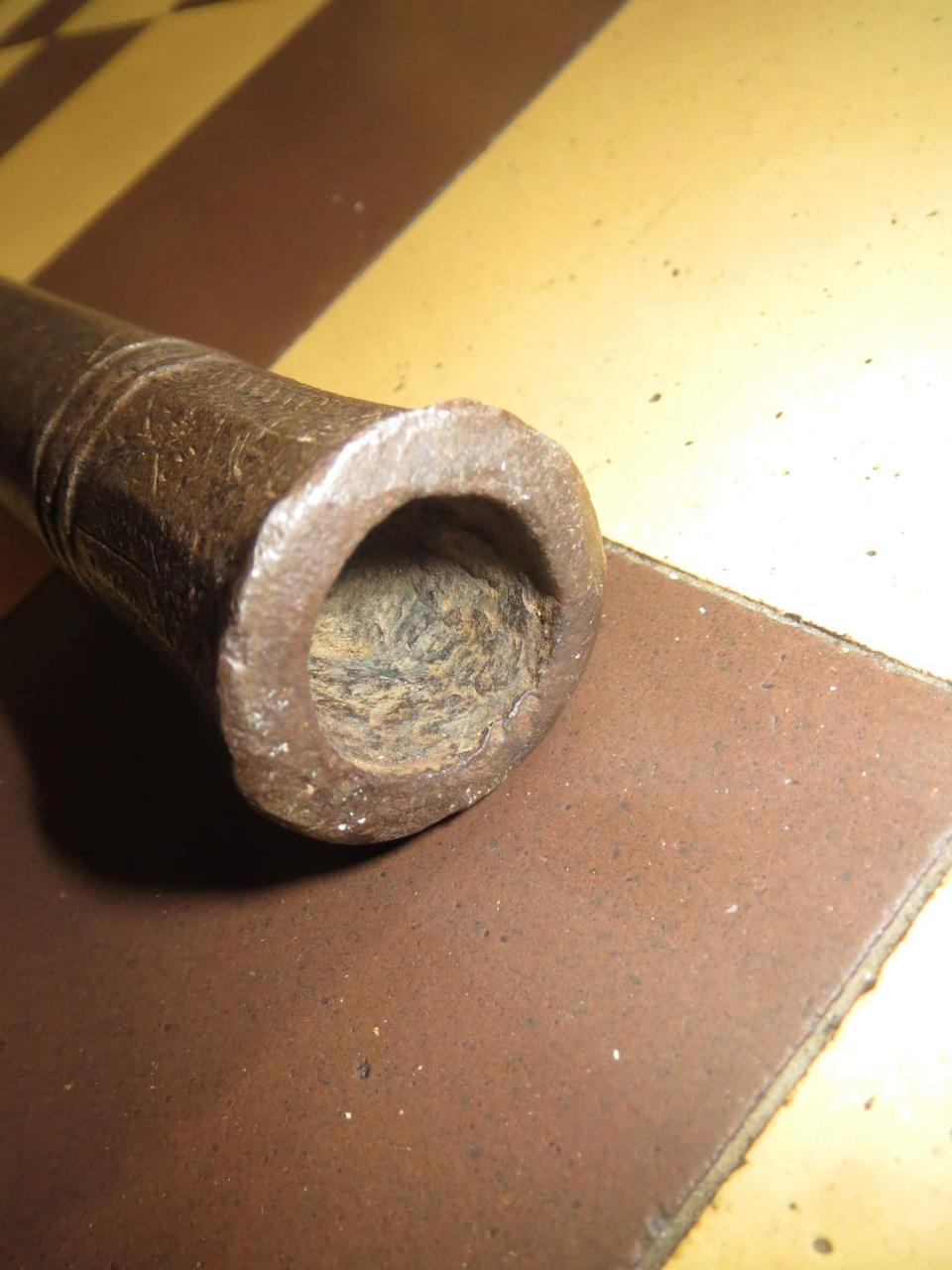

It is a very small handgonne or hand cannon. Total length is 103cm, barrel length 21cm. The caliber I think is max. 1,5cm but is difficult to measure because the barrel on the inside is quite rusty.
It has some decoration on it that made me decide to post it in the ethnographic category. I could be wrong!
There is also, what I think is, a human-like figure on it.
Anyone have any idea where and when this was made?
Of course I did some research on the internet and have read the thread on handgonne's on this forum. They do not match this thing. I did found a drawing that looks a bit like it.
Thanks in advance for your response!

This could possibly be a late handgonne, perhaps first half 15th cent. by virtue of its side-mounted integral priming pan and corresponding touchhole. Being derived from artillery pieces, the early ones tended to have touchholes at the 12-o'clock position. The hole and pan on the right side of the barrel would of course be the next step along in the evolution towards the matchlock barrel.

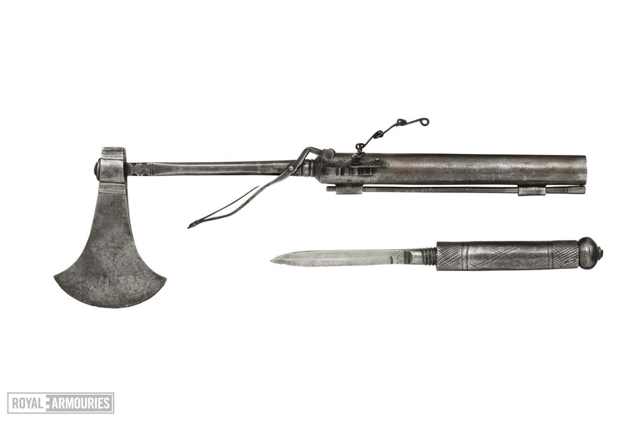

Looks like it started life as an Indian combined matchlock and axe. The Royal armouries example dates it vaguely 1700 to 1800. Worth looking to see if their is any sign the remains of a rivit to the tiller that could have supported the serpentine.

Thank you for your comment Raf. There is now sign of a rivet to the tiller. The tiller doesn't look strong enough to support an ax either.

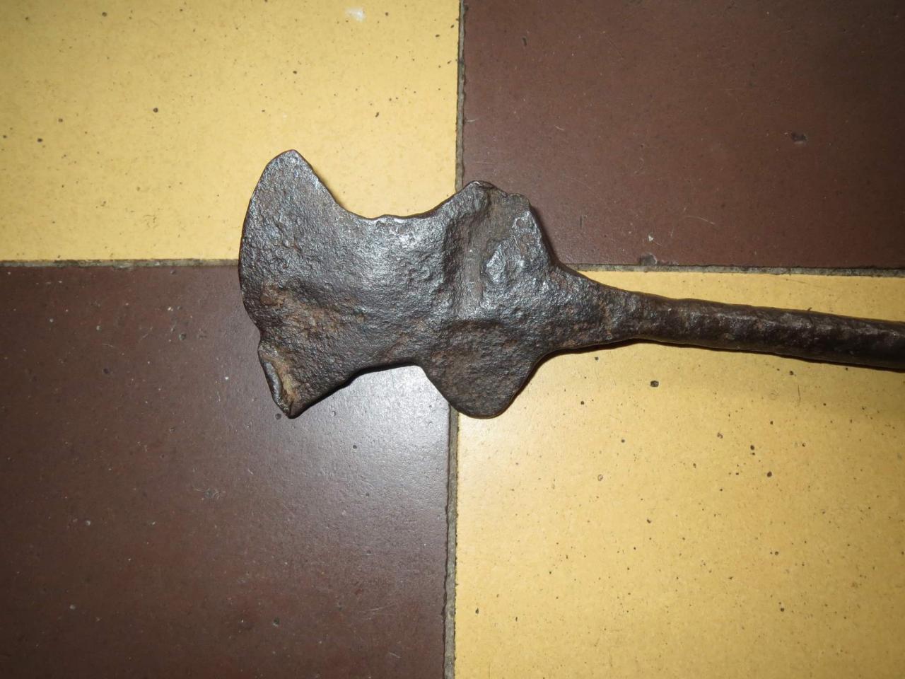

I agree. Maybe you could post a picture of the end of the tiller.

Attached from my archive

Thanks Marcus. Certainly looks like a tiller to me. One option might be it was designed to be fired from a rowlock fixed to the bow of a camel saddle in which case the tiller makes sense. There is a discussion of camel mounted guns in a thread started by Ibrahim Al Balooshi June 10 2016.
