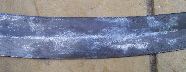

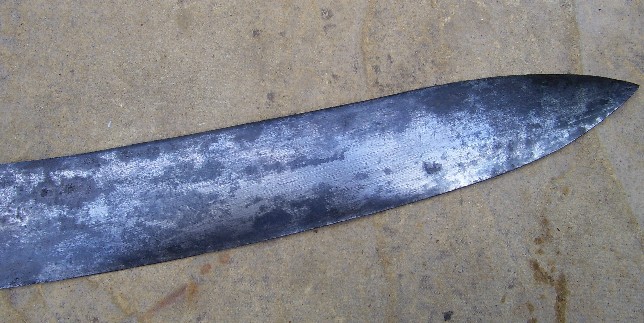

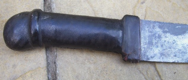

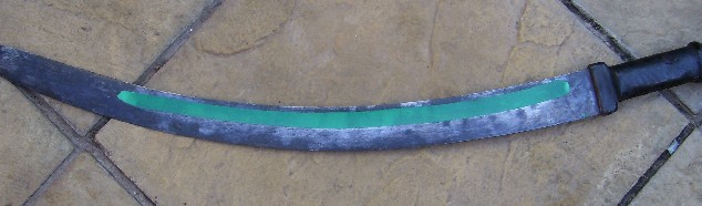

Finally .....the sword has arrived. Nice solid feel, nice balance and relatively 'heavy'. Some deep pitting and nice patination on the blade. I can't find any markings at all.
Taken a number of measurements.... hoping that someone may be able to identify the European (?) blade. Thankyou
The spine (back) is 4mm thick, then at approx,18cms before the tip it thins to approx 1mm.

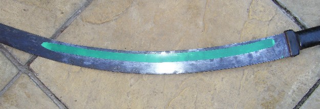

It has a broad fuller, both sides (18mm wide) and is 38cm long which follows the curve of the blade. Because the photos do not show this clearly I have applied tape to show position.
The blade is 48mm wide at handle, slightly tapering to 42mm approx. 15cms before point, then tapers again to 38mm just before point.
The blade measures 70.5cm, following the curve (of the blade), handle is 15cms long.

That is quite a blade. I think it must be European.

Has anyone any ideas on the pattern (of the blade) A French M1792 pattern was suggested by Jim, however he felt that the curve (of this blade) was more acute than that.

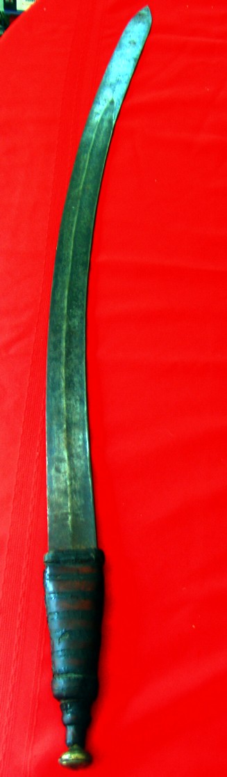

Something similar.

It's a Manding sword I just picked up on Ebay. No markings on the blade. Definitely produced by and industrialized society. My guess would be early 1900's.

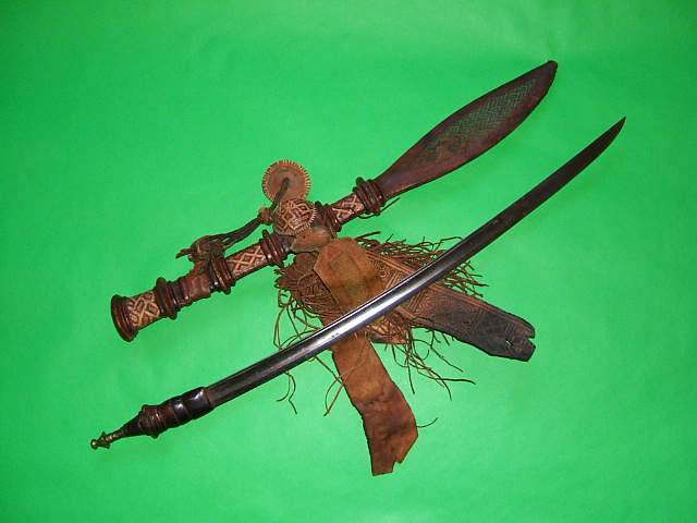

Originally Posted by katana
Considering the conflict between the French and the Manding people in the 19c. France is looking most likely as the provider of the blade.

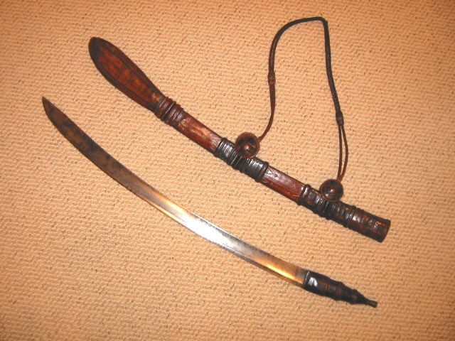

Hi Guys
I have two Manding swords and both have European /French blades. Here are both of them.
Lew

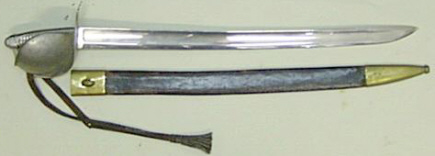

French and then German 19th naval cutlasses from the National Maritime Museum and the Reme Museum. This does not mean yours is not French or German for that matter. It could be an older pattern or from some other country even suppled as trade?
