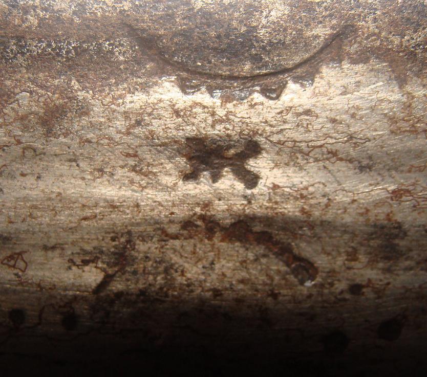

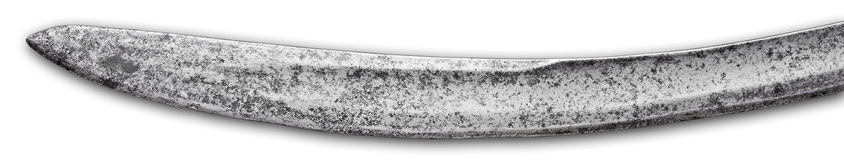

Hello Everyone,
can someone help me out, point me a direction (to a book or another source) or may know anything about that mark on an Italian Sword dated ca. 1580. Wheter it is a makers mark, inspection mark or whatever. It is the only mark on the blade, at the Ricasso. I have seen similiar ones from/out of Veneto but never a single one like this.
Thanks!
Ray

Hello Ray ... welcome to our forum
You are right in that this is a mark showing in Italian (Veneto) blades of the XV-XVI centuries, as indeed these often appear in a multiple mode and not one alone. I would venture that this is more the type of region or quality mark and not a smith's signature.
However these are all guesses; other members will show up with more knowledgeable comments about it.
Meanwhile we expect you to show us pictures of the whole sword, to let us see what we are talking about.

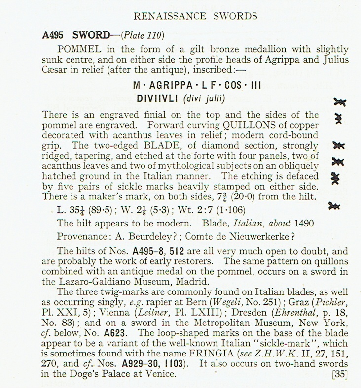

I found this mark in a German book: "Wendelin Boeheim, Handbuch der Waffenkunde". The translation is: Unknown, probably mark of a blade smith at Brescia 16th century.
corrado26

I found this mark in a German book: "Wendelin Boeheim, Handbuch der Waffenkunde". The translation is: Unknown, probably mark of a blade smith at Brescia 16th century. A scan of a page of the Catalogue of the Wallace Collection, European Arms and Armour shows under number A495 this mark on a sword from about 1490.
corrado26

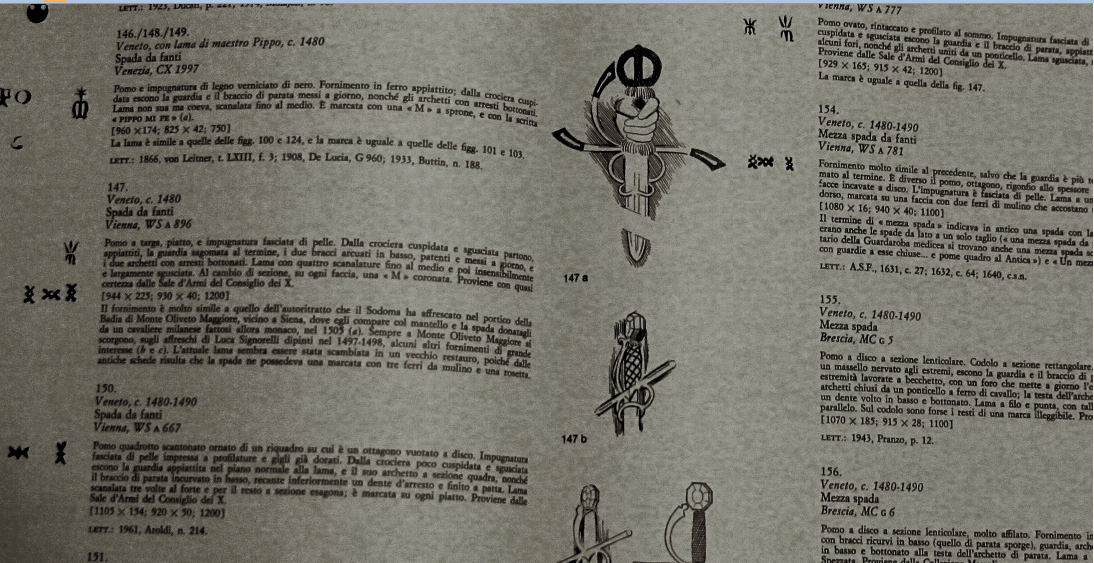

Apparently you guys skipped over a "detail" in that Ray is already aware that these (Veneto) marks exist, although in numbers of more than one; what he is asking is whether we are familiar with them only showing in one single presence; reason why i didn't post images of the 'multi' ones in the first place. Also we haven't yet had a picture of the whole sword, to then enable us to weave considerations on it.
But let me then play the accomplice and upload a couple pages of Armi Bianchi Italiane, where these "ferri di molino" (as they call them) appear. Pity this great work authors do not define the purpose of these marks.

Thanks for the Boccia & Coelho pages Fernando. I agree in most cases it is beneficial to have images of the whole sword, but for me I am OK with this image for now. I guess the reason is that this singular usage may indicate a 'trade blade' character rather than a completed sword matter.
To clarify what I meant by that designation is that it seems the singular use of this stamped mark on a blade seems to indicate Italian manufacture, but obviously that cannot be stated for certain. It simply has not seemed to me that these 'twig' marks turn up on German or other blades, and particularly not in singular case.
I think that these type marks are more of a mundane administrative device than the more distinctive makers or guild marks, which were often a matter of record as they involved compliances and ordinances. For example, these may indicate batches of swords involved in a specified contract or order.

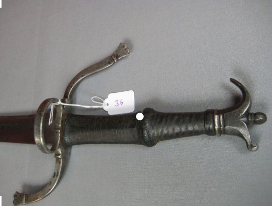

I have seen these single marks of the twig type on blades, on schiavona and another even on a kaskara (backsword blade most unusual on these). It would seem of course that the 'blade' was independent of the sword assembly in origin in these cases, obviously with the kaskara
