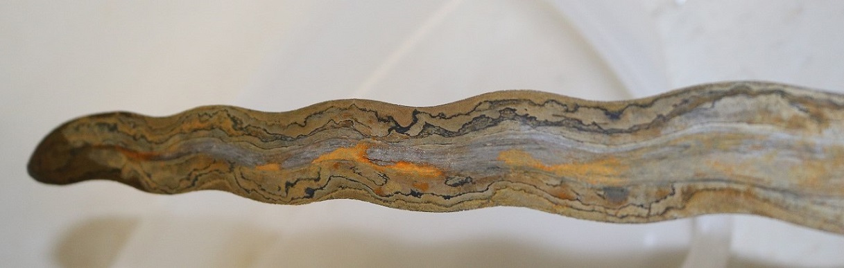

Hi, can anyone share opinions & possible origins about this moro kris based on its style and form?

There is a separating line that seems to be real rather than merely engraved. From the pic, I can't see how the angled part is designed. Larger pics would be needed for verification and estimation of age. Dimensions would be good to have, too.
The blade probably is Maguindanao; the hilt might point towards the upper Cota Bato region.

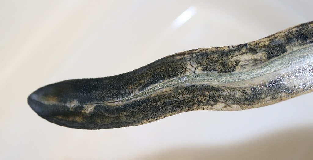

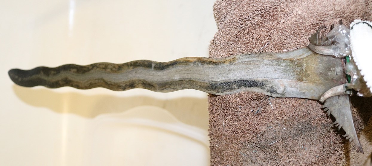

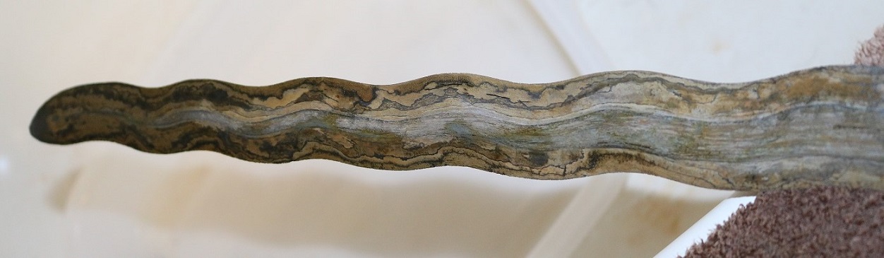

I have left the blade in a vertical bath of 5% vinegar for a couple days and tried to clean it a couple times by running water over it and scrubbing.
The dark smudge develops really fast after resubmerging in the vinegar. It develops thick again at both sides, and when I take it out of the bath to rinse it off with water and scrub it smells REALLY RANCID AND PUNGENT!!!! (Is it a toxin or hazardous to inhale)? My mind may be going overboard, but I wonder if it's arsneic or something? Any way, I was scrubbing it with a plastic brush very hard with citric dish soap thinking it will scrub the black smudge away, but it didnt seem to do much.
Then I realised that the black smudge actually fades away when the blade dries. The last photo shows what it looks like when it is almost completely dry. Is the rust not being removed or am I making some progress?

Uh..........maybe a little over etched. You may want to repolish and etch with a little distilled water, or don't leave the blade in that long.

I think that we don't see an intended etch, it will be the result of the bath in 5% vinegar solution to loosen the rust.
That's what I said before, the blade need to get polished anyway after the bath. The blade wasn't corroded so much that the bath was required.

I agree Detlef. This blade needs some sand papering and polishing, then a final etch. The red area in the bottom picture is active oxidation that needs rubbing off also.
