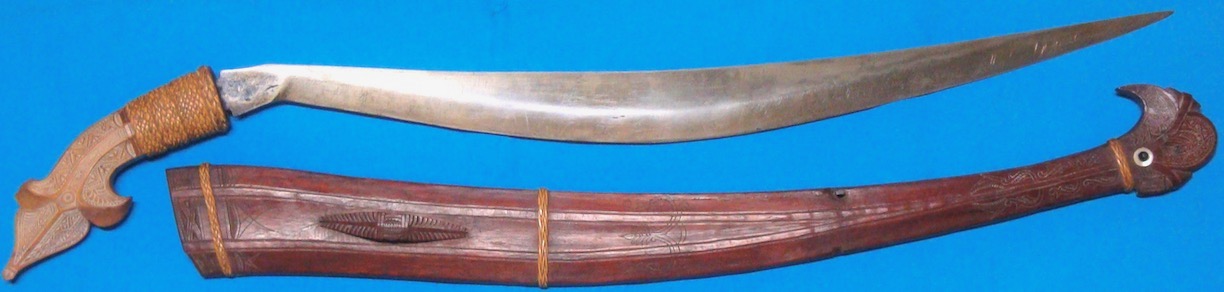

Greetings folks,
I think my original thread years ago on this subject got disappeared with the loss of others a while back. So I thought I would recreate a thread on this for research.
I found this talibon years ago in a antique mall. This is how it looked. As you can tell, the problems are that there is an old break on one lobe of the hilt, and a huge break on the opposite half of the hilt. Also, there is a crack in the back, one of the braided bands on the scabbard is missing, as well as cracks in the scabbard.
Old 14th October 2019, 02:45 AM   #2
Posts: 7,421
Now here are my attempts at restoration. I left the small break alone since the patina matches the rest of the hilt patina, meaning it was done during the time it was in service. However, I painstakingly restored the missing half of the hilt - the patina was very light compared to the rest of the wood and indicated to me that it was done in the recent past. Lots of careful carving.
Also I glued and painted the other cracks.
Here are the results:

The repair looks great Battara. Will you repair the broken part of the top of the pommel?
Looks like this was very difficult.

Very good restore work!
Old 14th October 2019, 06:34 PM   #8
Posts: 7,421
Thank you folks!
Yes this was very difficult and time consuming. By bottom part of the hilt I assume you mean this:
