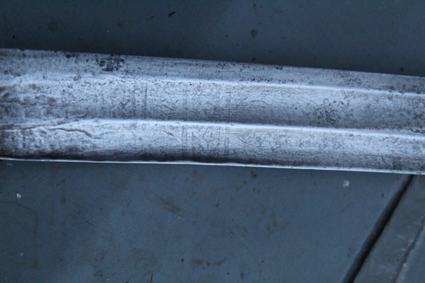

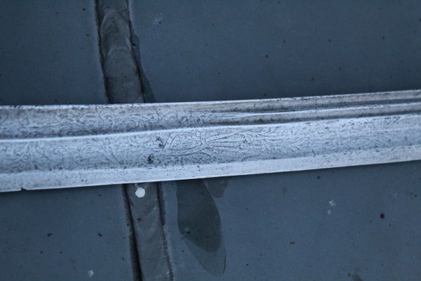

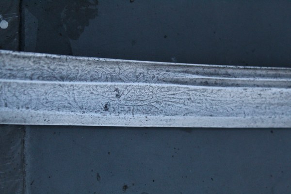

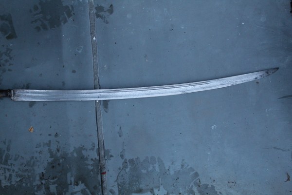

I would like to have information about the origin, age and model of this blade.
It is mounted in Atjeh sikin pasangang fittings, but the blade shows european style etching as well as damast pattern.

The basic pattern of the blade suggests obviously a cavalry sabre blade, probably East European and of the latter 18th century into early 19th. The etching style, though extremely worn and indiscernible in the photos is of course indicating an officers sword.
Without searching through references to match the interesting fuller arrangement to classify possible nationality of this blade, the key factor in its appearance in this Indonesian context is of course trade. While the Dutch predominated control in these regions, there are likely a good number of possibilities how this blade ended up in these Atjeh mounts. Only speculation by those more familiar with these trade activities and regional history can offer more viable solution.

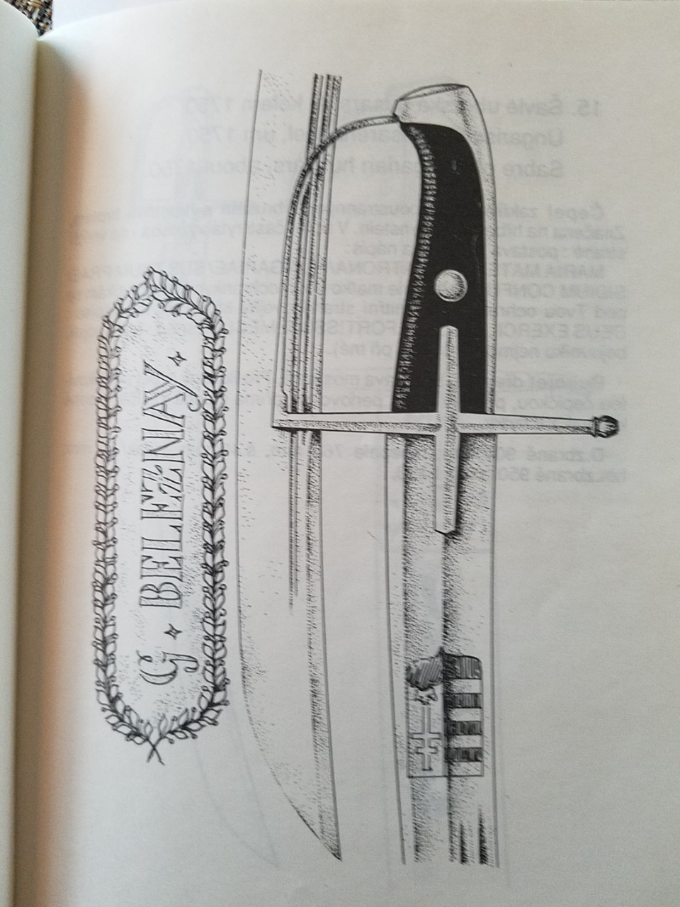

I checked my copy of "Edged Weapons of the Habsburg Monarchy 16th-20thc" (Konipsky & Moudry, Prague, 1991) as I felt this blade resembled one of East Europe, and found two examples which seem plausibly connected.
The one with the coat of arms on the blade ( p.43 ; #14) is from Hungarian hussars c. 1751-54.
The other is Austrian light cavalry first half of 19th c.
What drew me to these types were the multiple fullers in the distal half of the blade, while the beginning of the blade is of hollow ground form. With these two blades, the later (19th c,) form has three fullers.....however the style of etching seems more in line with this example Willem has.
The earlier blade seems to be in line with the fuller pattern of Willem's but this type etching inconsistant.

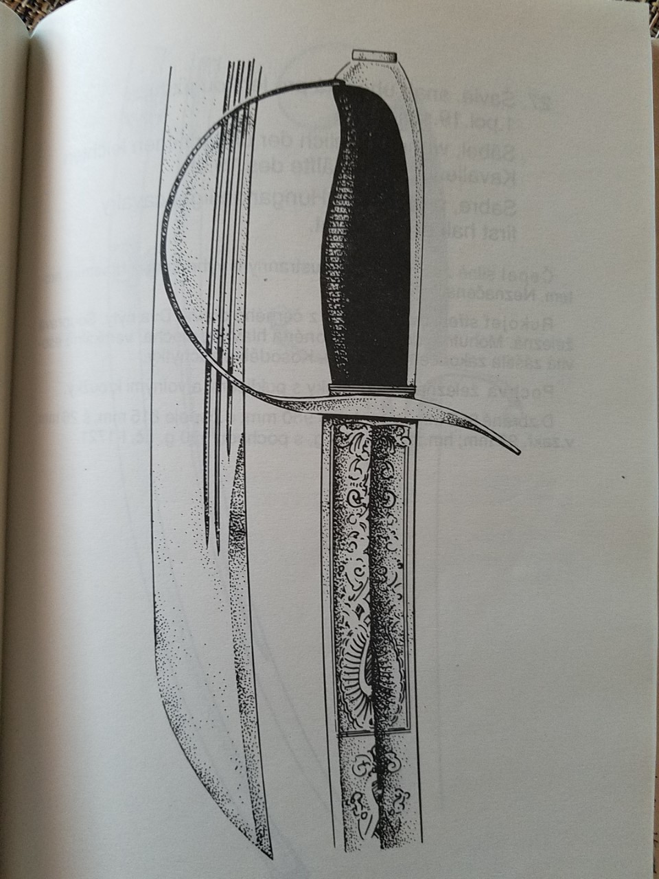

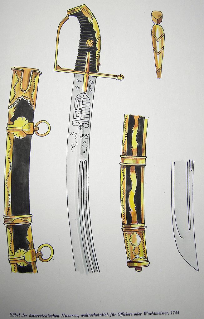

Here is another picture of an Austrian husar sabre for officers about 1744 with similar details of the blade. The drawings of the blade in question, especially the shield and arms on one side visible have a very European aspect.
corrado26
