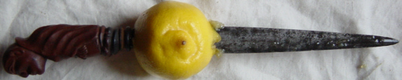

I have the tombak set up like this, in the opening of a pot. It has been like this for about 4 hours, I think something is happening I can smell it. Every now and again I move the blade in and out of the lemon to keep the juice wet. How long should I keep this up, days?

This seems like a somewhat awkward set up to me Tim. Is there some reason why you didn't just remove the hilt and immerse the blade totally in something like pineapple juice. I wouldn't think the citrus is all that helpful to the hilt anyway. With total immersion you wouldn't have to worry about moving the blade in and out all the time. The cleaning would be more even. I'm also not sure you will get a "white" blade this way. If your photos are any indication it looks like the citrus has re-activated some of the old warangan. At least it appears that the iron is darkening in some areas, especially around the edges and lightening where there may be pamor. But perhaps that is just a photographic illusion. If you plan on re-staining this one you might need to employ a bit of scrubbing to get this tombak "white". Of course, if you don't plan on restaining, the lemon treatment might just bring out the pamor to your satisfaction. Either way, be sure to neutralize the citrus with something like a slurry of baking soda to stop the action of the etch.
Old 14th May 2006, 09:53 PM   #15
Posts: 6,029
I felt urged into this, it is a live experiment. The handle does not want come off and I am not going to pull it off. Now I have started I think I should go all the way, with guidance I hope . I hope my pictures will be good enough.
I can already see that the blade is quite old and more pitted than I thought. The juice does seem to be reacting and making darker looking areas. If I wipe off the juice, it is at the moment a little more difficult to see the pamor/forging. However when I inspect the blade with a glass I think more interesting patterns are being revealed. I will carry on for a day or two, then come back with more pictures and attempt staining.

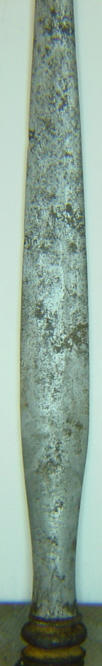

Old 18th May 2006, 12:07 PM   #16
Posts: 6,029
look at this now, hard to believe it is the same blade.
It has no patina and although interesting rather harsh. I do not know how I feel about this .
One side appears more patterned but this may change with staining. As it is now apart from the silver coloured patterns there seems three shades in the metal. I am glad this blade was no bigger, picking with a x10 loop and a dental probe is not the best way to pass time.
I am at you keris fans mercy where do I go from here? how long does the stain affect last?

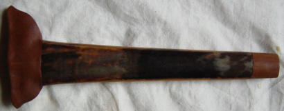

Tim Simmons, you will find that gentle heat at the blade base , just in front of the metuk, will allow you free the handle. Use aluminium jaws, or wood blocks, in a vice, gently heat the blade base---you use a small kerosene lamp, or a candle, or if you have a delicate touch, a propane torch---twist and pull the handle, it will come free. To clean and stain this blade properly you must remove the handle. You cannot do the job properly with the handle still in place, and you will finish up damaging the handle.

This is the state of the blade right now. With a loop I can see there are still some lumps to come off.
The handle? On inspection this has been in place some time, there are signs of threads or cloth at the join. How much of a can of worms will taking the handle off be? how to put it back? with what?
Am I just telling myself there are patterns emerging in this blade? poor pictures but you people know more what you are looking at. Is it worth continuing or shall I stop now?
