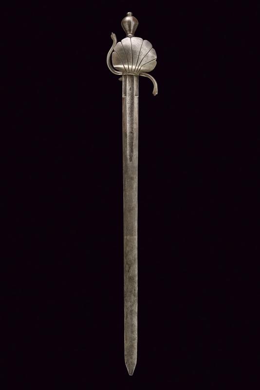

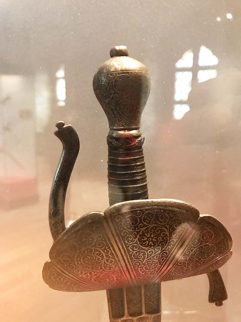

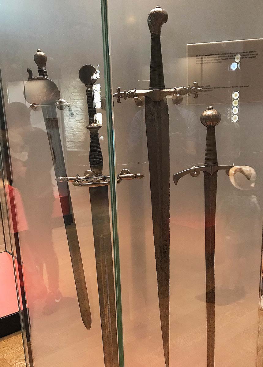

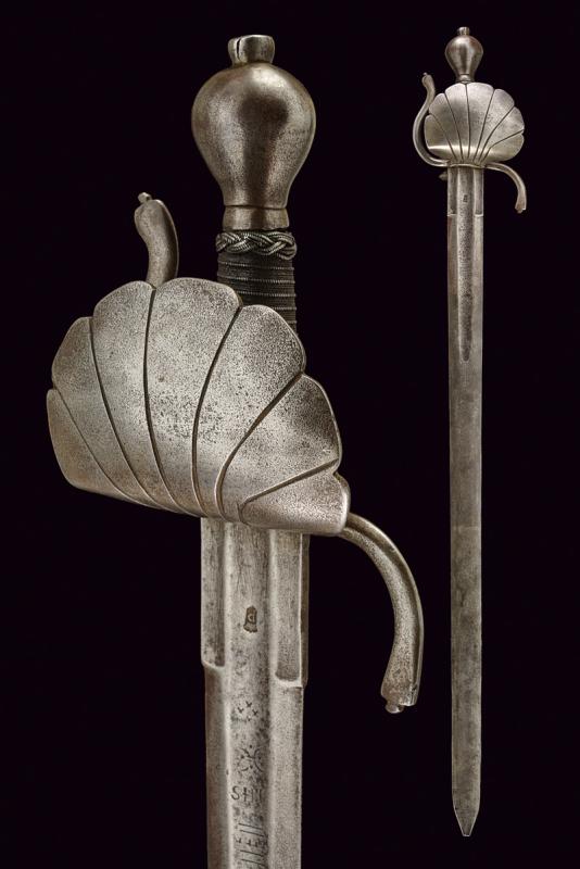

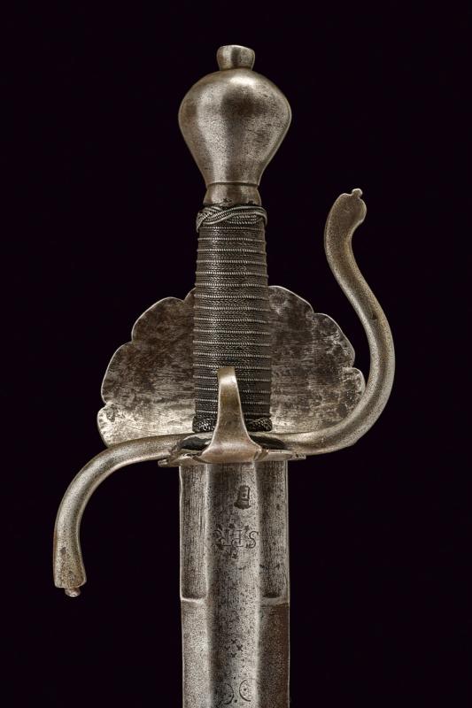

Other similar hilts in the Gravensteen Gent Belgium and also one sold in Czerny's
Best
cerjak

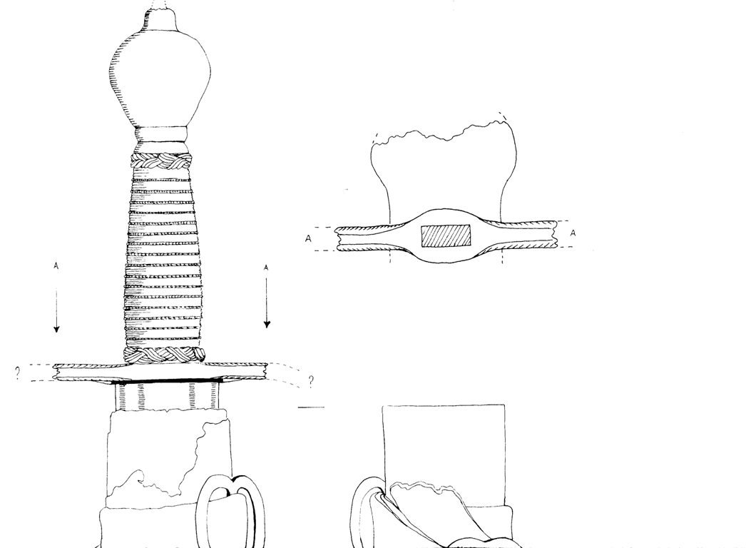

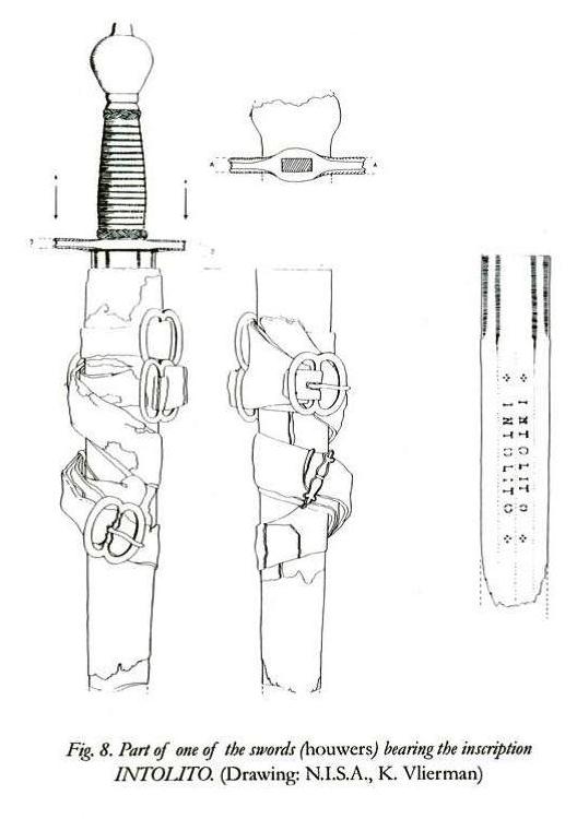

In or before 1978 the wreck of a flatboat was found in the lake what once was the Zuyderzee. This boat was full of arms and military equipment, destined for what were army outposts on islands against a possible French invasion in 1672. Among the cargo were four swords with seashell guards and straight blades. In the attachment are two archaeological drawings.
All this does not bring us definitive answers to the probrem when we view the portrait of the French privateer l'Olonnais (spelled as Lolonois) in which he is holding a seashell-hilited cutlass with curved blade with clipped point. I do not know of the actual existence of such a sword - nowhere in the world. I dare not go so far as to suggest that swords of this type may be artists' impressions only but somehow it does feel that way!
