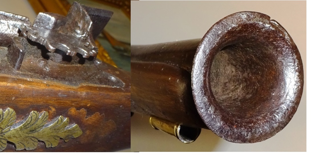

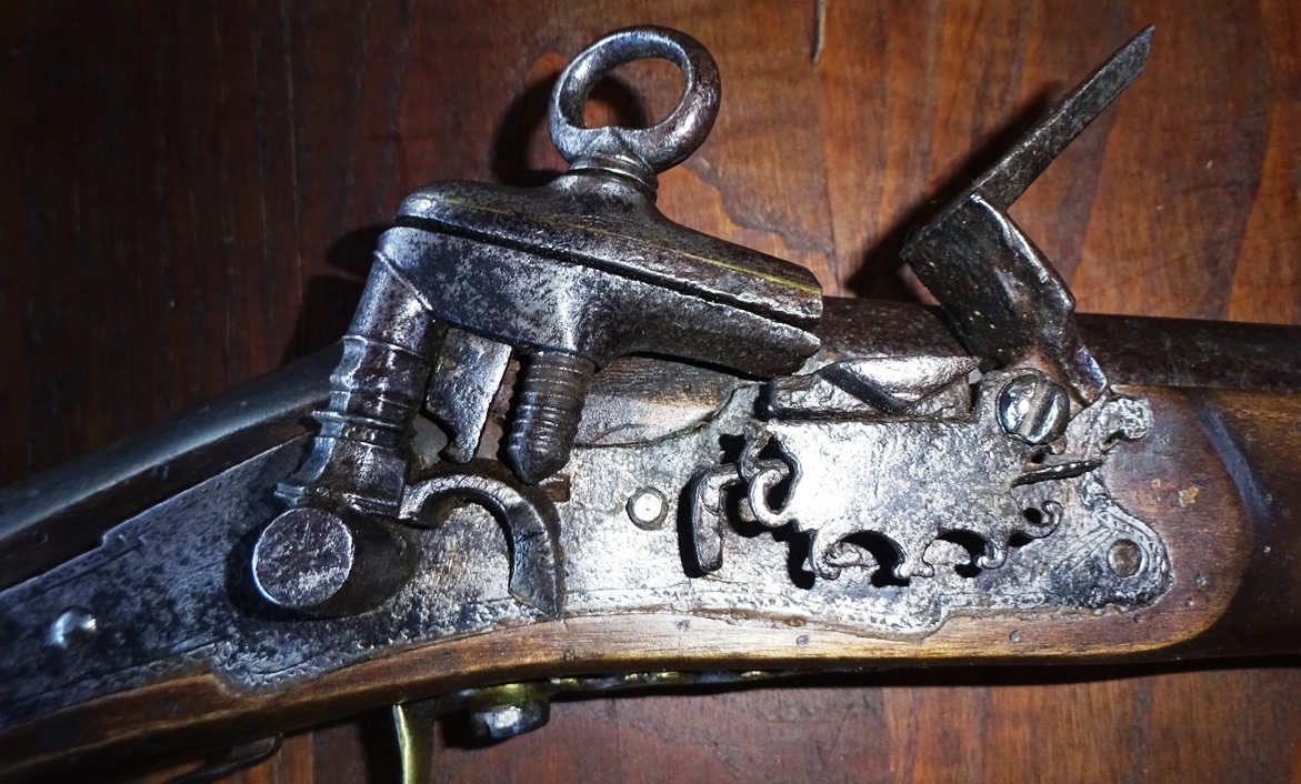

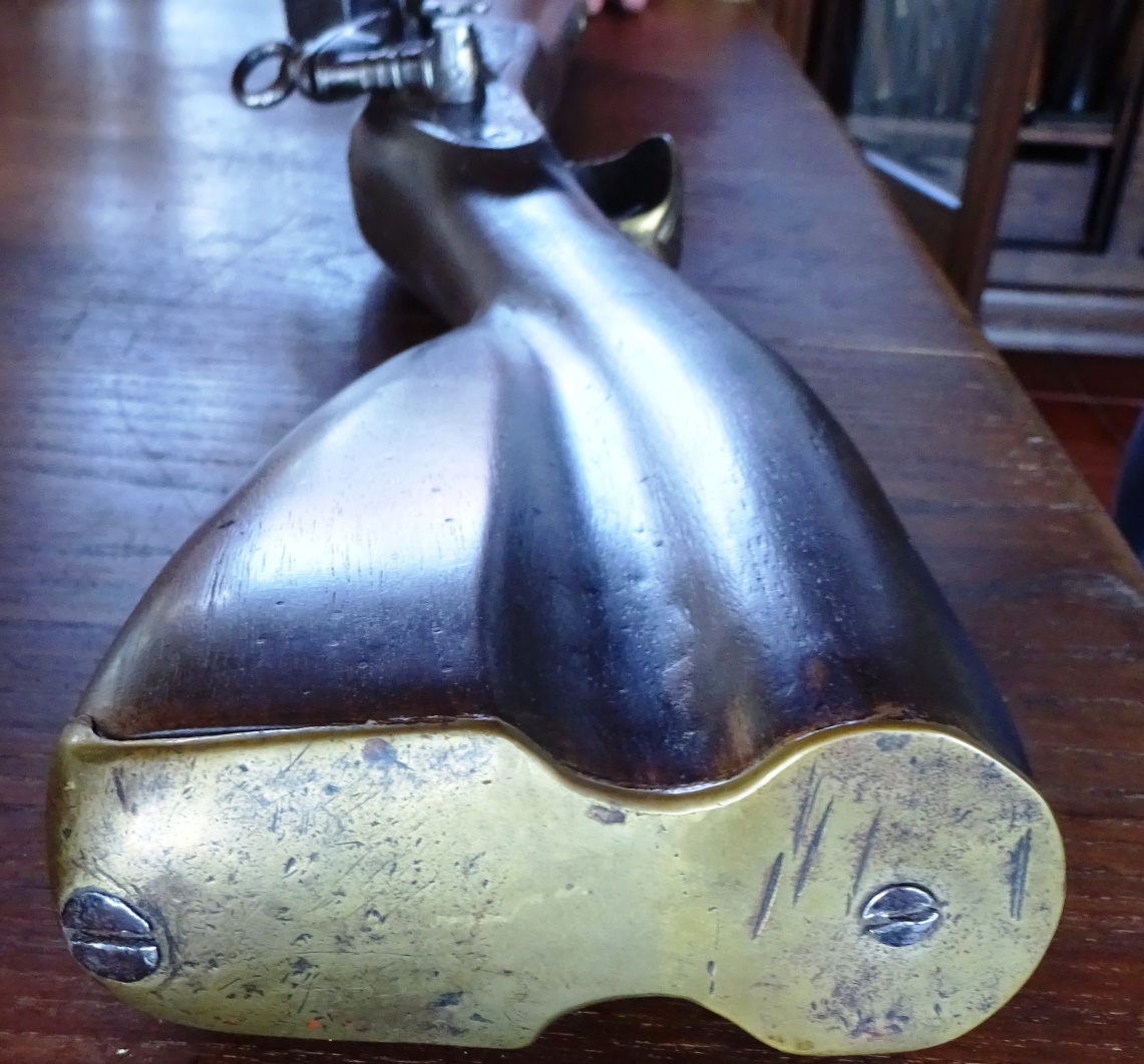

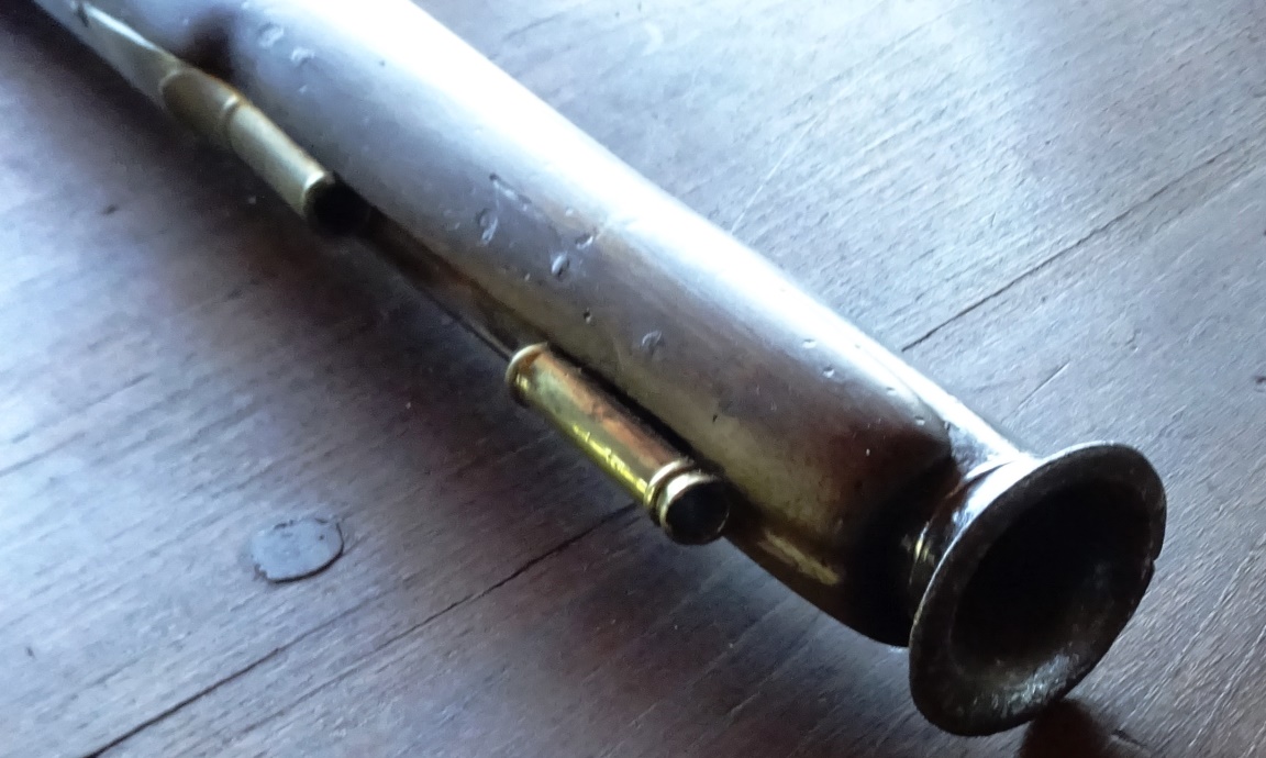

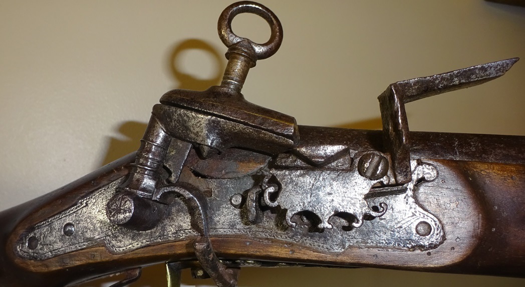

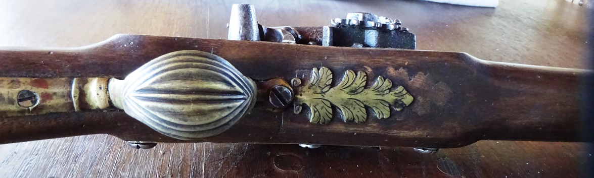

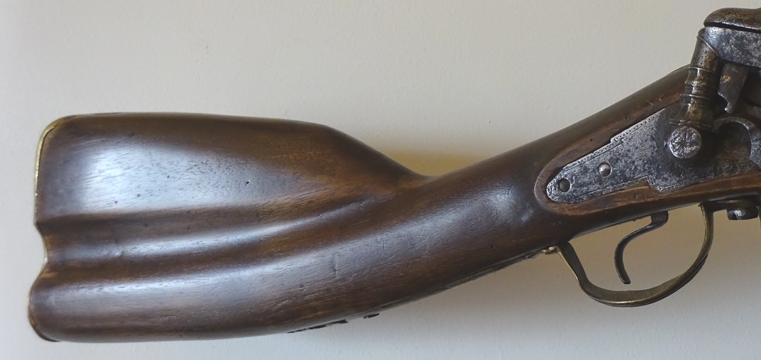

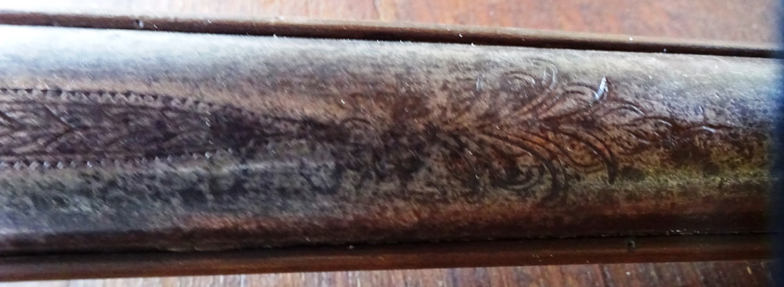

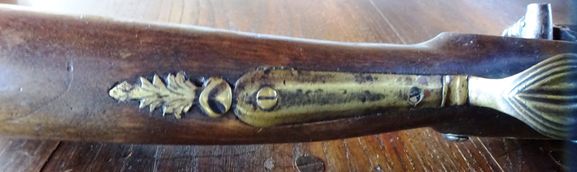

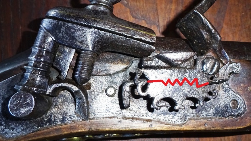

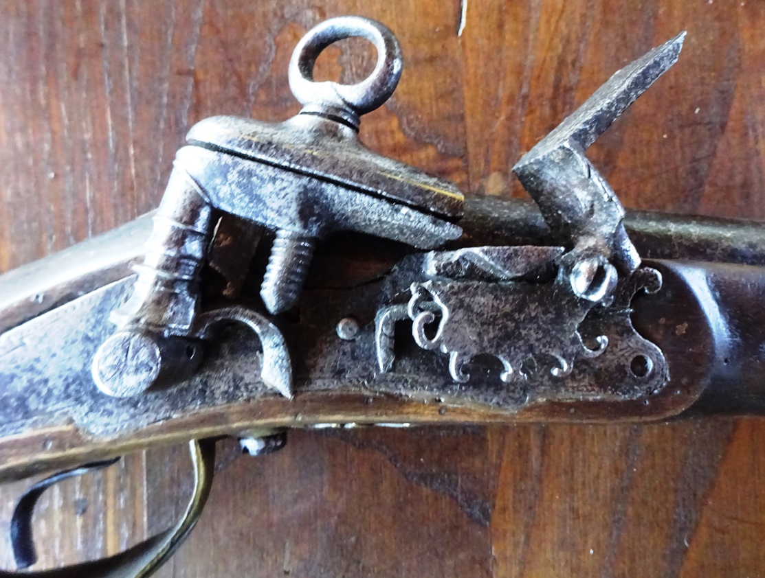

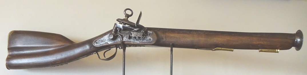

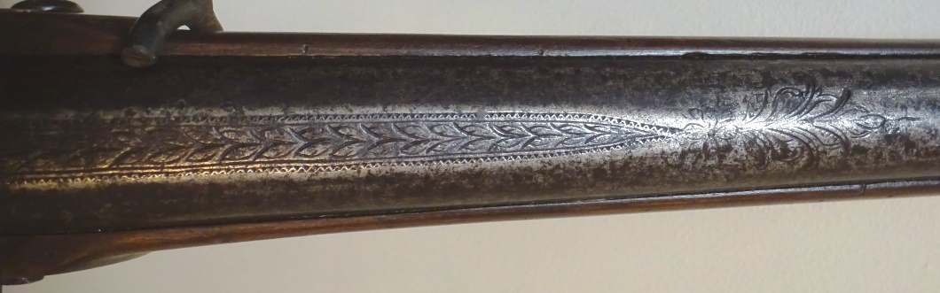

Pictures are horrible; i thought i had enough light, but i was wrong. This one belongs to a local fellow collector, who refuses to pass it me, arguing that he already let go a couple of them to my collection.
I am amazed with the lock adornment, the atypical stock shape, the barrel engravings. In principle a Portuguese example, the trigger guard denouncing it, for one... as also having been locally acquired.
Have you guys ever seen such lock 'mirror' ? I would be much obliged for your comments.

The most interesting (for me) lock, a rare mix of Museta and Mimi (as the opera says) a mixture of the classic miquelete with the "Molinhas clasp", because it has "pin" and has a false flange in the bowl, As in the classic miquelete. The half-cock chock must be on the inner curve of the side. As in the Spanish "mixed lock" the firing system is at the top, above the actual quay

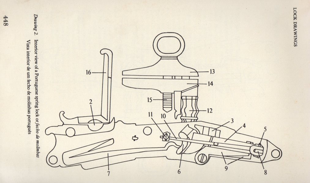

http://www.vikingsword.com/vb/showth...fecho+Molinhas
Comparation with

Thank you tocayo,
To avoid misunderstandings, the attribution of the "Fecho de Molinhas" name is not due to external parts of such lock system but to a specific 'playing' of its internal sears (muelles) and rods (as per attached drawing, positions #9 and #10).
The hammer type in this blunderbuss i am posting we call it here "goat's foot" (pie de cabra).

The # 9 is a double spring, which activates the catch and the trigger. The # 10 is simply a rod, which has its bearing in # 11 and that only serves to guide the trigger

The rod has a perpendicular projection, on which the trigger is supported, because the trigger of the lock is delayed in the position in the weapon, and thus it advances the position in which its action exerts its trigger of the weapon, not of the key

I hope you do manage to talk the guy out of it eventually. A most interesting and unusual piece. The "goats foot" lock is particularly appealing to me. Baaaaa-aaahd!

Besides the goats foot, i like the atypical stock and love that frizzen spring 'shield', which must have been the pride of its original owner.

Besides the goats foot, i like the atypical stock and love that frizzen spring 'shield', which must have been the pride of its original owner.[/QUOTE]
Fernando,

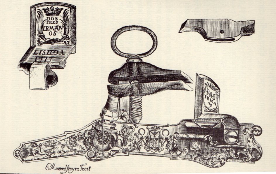

I recently got my copy of Daehnhardt/Gaier ESPINGARDARIA PORTUGUESA and have been studying the examples of pé-de-cabra locks in the exhibit. The three pistols are all dated to the first quarter of the 19th cent., and the locks have features true-to-form for that era. For instance, the two in plate 11 (p 45) have French-style lockplates; the one in plate 14 (p 51) has a more conservative fecho de molinhas style plate BUT the cock's jaws are at a right angle to the stem which is a late fashion (you see it on later Spanish and Neapolitan miquelet cocks as well). NONE OF THESE LOCKS HAVE FRIZZEN-SPRING SHIELDS LIKE ON THIS BLUNDERBUSS.
The patilha lock on Dom João's hunting gun , plate 2, p 27 has a shield with ornamental curlicue extensions from its lower edge, with a repeated motif on the cock bridle as well. These curlicues are also seen on 17th cent. Spanish patilla locks (see J D Lavin. A HISTORY OF SPANISH FIREARMS, 1965, fig. 22), and survived in vestigial form on provincial locks into the following century (Lavin, plate 81). The shapes on the frizzen shield of your friend's gun appear to me as an especially flamboyant, perhaps provincial, interpretation of this aesthetic. As though a Portuguese gunsmith, familiar with Spanish prototypes, decided to dial up the degree of ornamentation and do one better!
A lot of features of the rest of the gun point to perhaps end 18th cent and later, but the style of the lock, plus the amount of wear and pitting, suggest that it is an older mechanism re-used. I agree that the stock is unusual, but the lock may exceed it in significance and age. Even more reason to try every means to pry it out of your friend's paws.

So ... finally mine .
New pictures are not necessarily better but, it obliges .

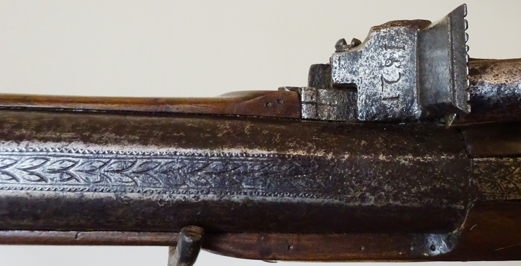

As usual these local rural blunderbusses are composed of whatever origin components; only that, in this case, they all seem to be Portuguese, contrary to those with British parts, namely salvaged from the Peninsular War.

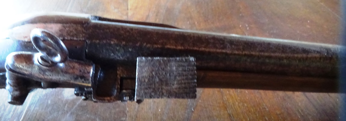

The frizzen dated 1821 would be the main issue, as this ought to be a replacer, judging by the fact that these 'three screw locks' are certainly earlier (mid-end 18th century ...). It also plays a lot loose, not due ro its visible battery wearing but to its 'foot' being much narrower than its pivot section.

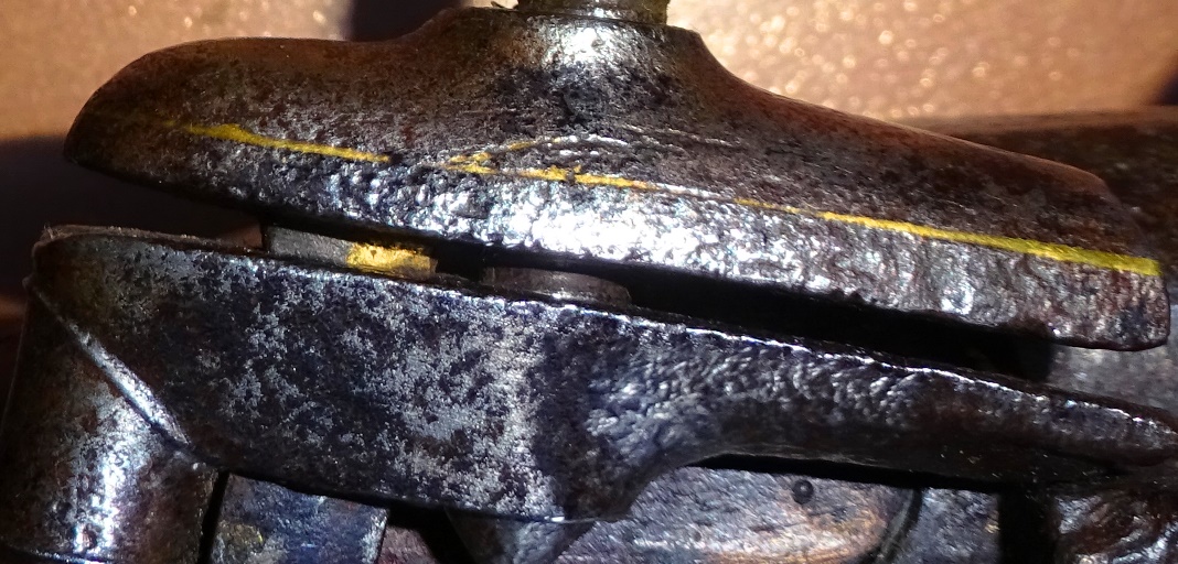

A second note goes for the detail in the upper jaw; a gold 'filet' that is not present inits lower part nor in the rest of the decoration.

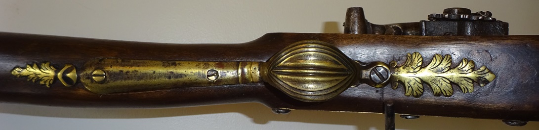

There are also traces that the beautiful trigger guard has a story to tell, judging by the wood marks in the front.

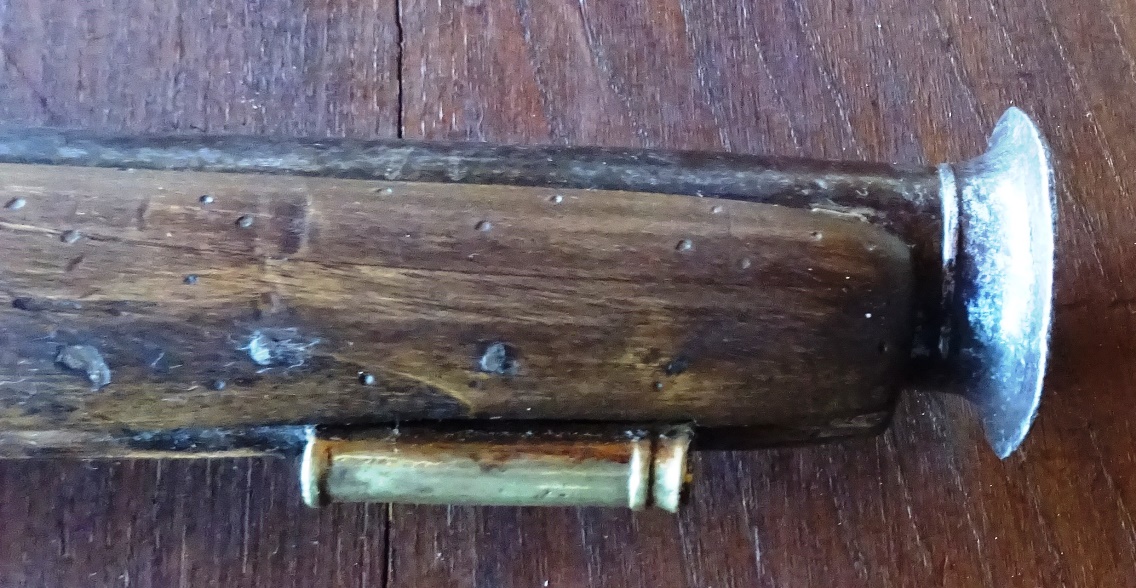

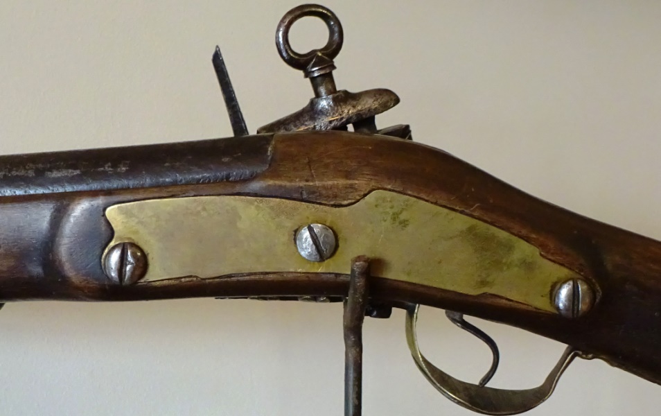

A final note for the stock, which seems to be offset, denouncing an 'advanced' procedures.

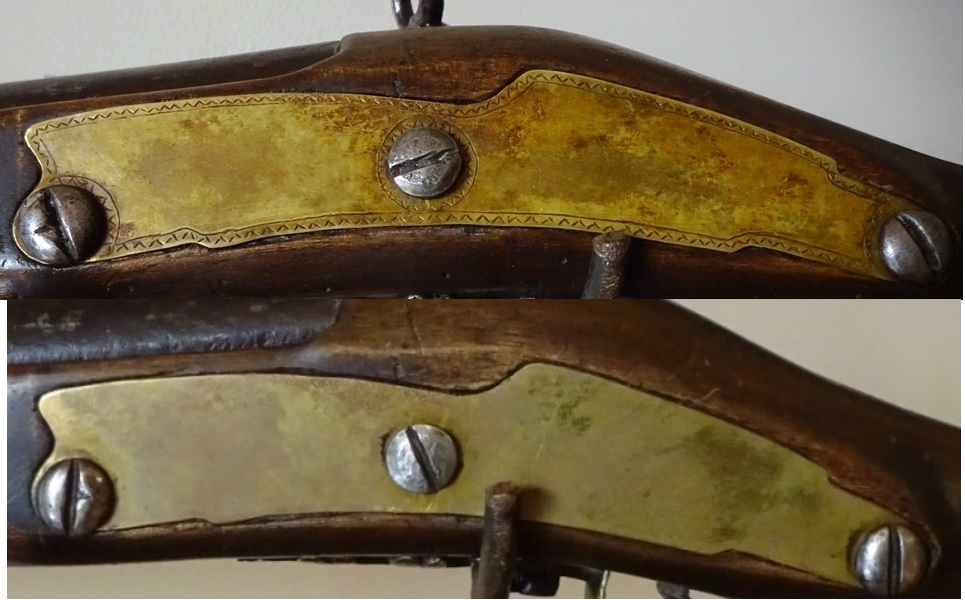

The side plate a plain brass replacement; i am making arrangements for a local engraver to chisel some decoration familiar to the one in the main lock plate.

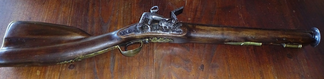

Now it doesn't look so dull. Look at the difference; one hour in the smith.

Congratulations! All good things come to those who lie in wait. It looks a lot cleaner and more presentable as well now that it's in your possession.

I think, the date "1821" got nothing to do with the year of production. Maybe it is a memory for something important in the life of the owner and so on.
The golden filet on the upper jaw could also be a soldering seam from an old repairing job. The upper jaw is under high stress if the gun is fired.
