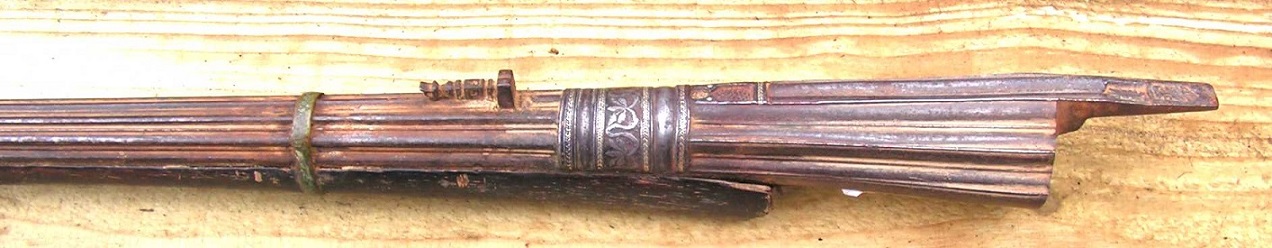

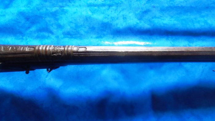

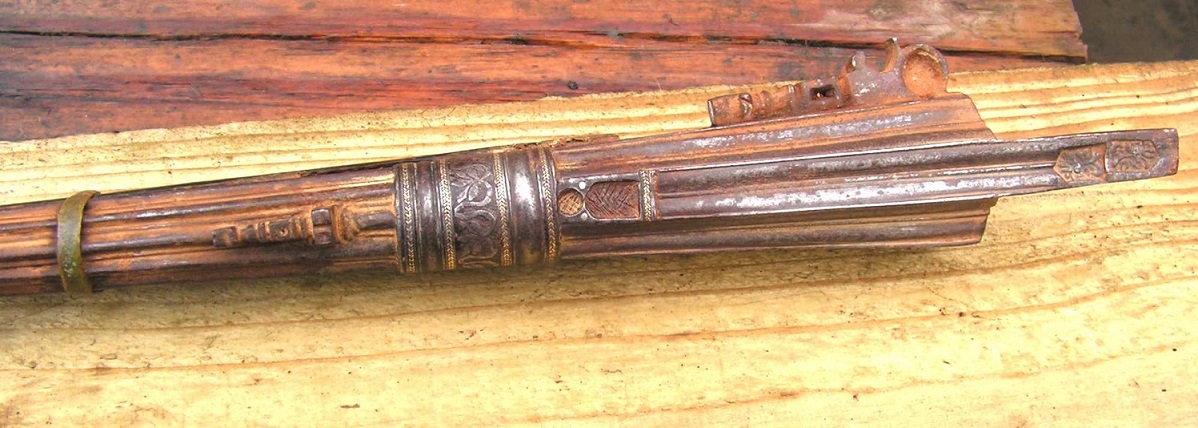

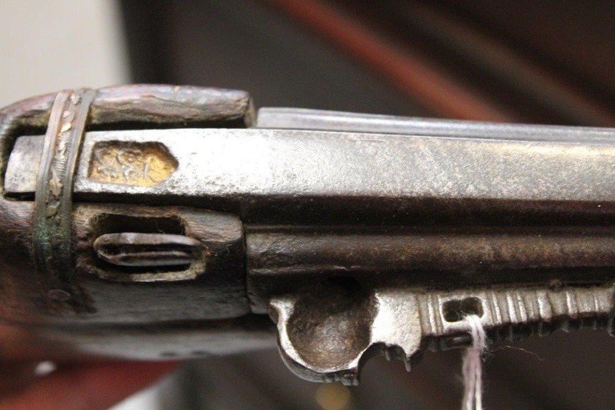

Thanks to Stu here on the Forum, I can say the barrel in this thread is Omani, and have a few questions about it;
1, I have seen barrels very similar to this, and in All cases the metal (gold?) in the cartouches has been removed.
This I can understand, as gold is valuable, but why in All cases?
These cartouches are all the same shape on the barrels I have seen, So!...
Were these cartouches stamped with a stamp of ownership?
Or, the maker's stamp?
I can see how if an owner sold off some arms/barrels, he may wish his stamp to be removed.
Any thoughts Gentlemen?
Also;
I gather such barrels were made over a long period.
Can anyone give in this case an idea of age?
And;
I have seen a few of these barrels stocked up.
The barrels appear high quality, yet the rest of the gun usually appears very rudimentary. Is there an explanation for this?
Thank you for your time,
Richard.

It is interesting ....The guns of Oman were seldom if ever made there... The majority appear to be imported and many were Persian made. The signatures on yours seem to be of Persian artesans . See also http://www.klm-mra.be/icomam/downloads/issue07.pdf and note that they consider a lot of the barrels to be European, perhaps German.
I seldom see gold on the barrels although silver appears often... See also http://www.vikingsword.com/vb/showth...ght=Omani+Guns

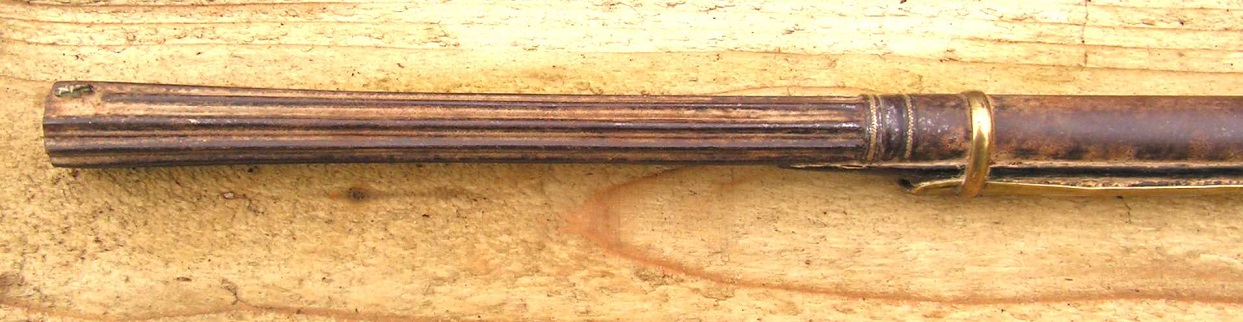

Update to this old thread;

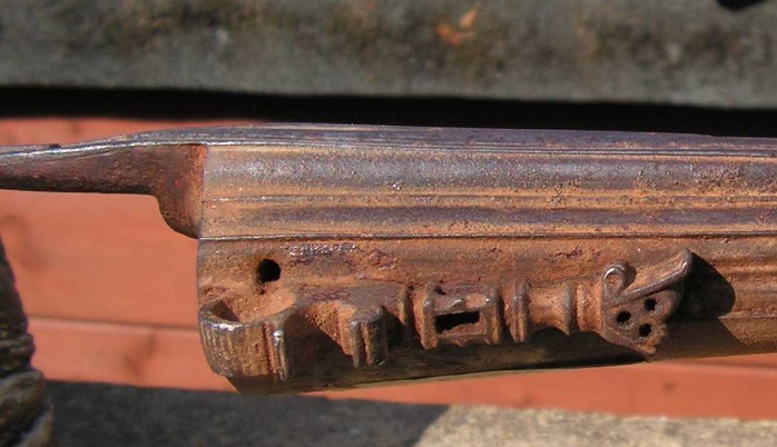

Having now two barrels of this type in hand, the barrel interiors have a somewhat constricted breech for the last few inches, and do not open out into a larger powder chamber as we so often encounter on Torador barrels.
Both barrels are a joy to look at, and are very slim and beautifully made. Both will be stocked up, (as time permits!)
Richard.

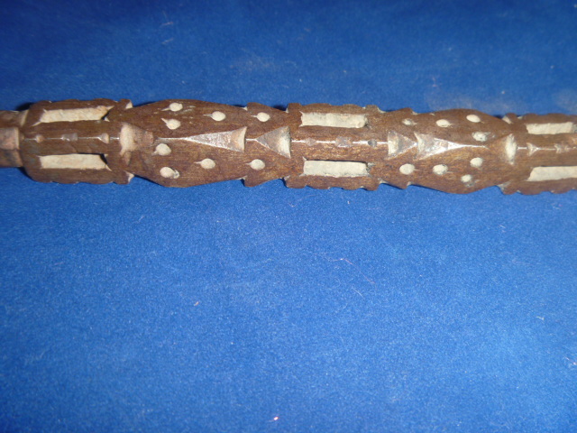

These are the barrels that Robin Wiggington said were from "another part of India " when addressing two such barrels in Tipu Sultan's collection.
(Stocked up actually in a more modern European style, with snapping mechanisms and self-opening pans!)
Elgood believes Persian, though.
What I Do Not understand is;
Why do we not see these barrels on Persian arms, (correct me if I am wrong)
Or on Indian arms very often? I know of the two previously mentioned in Tipu Sultan's armoury, and One other from Sind, stocked in the Afghan style.
One would imagine wherever they came from before being traded into Oman, there would have been Some of them left in the country of origin.
Of interest is the fact that the cartouches in Tipu's barrels had Also been removed, so these and the ones you have Ibrahiim, may have had said cartouches removed for a Very long time!
Question if I may Ibrahiim;
Have you seen any of these barrels with the silver cartouche still in place?
Thank you for your time.
Richard.
The answer is I don't know the answer! This stuff is getting very rare however...I would estimate the number of battle swords left in Oman at less than 20...and I have never seen a spear except in books/museums....ever. How many barrels are left out there... not many...Please see http://www.muscatdaily.com/Archive/O...d-viewing-1znc and my thread at Canons of Oman where it is considered at the time that a number of Abu Futilla were European/German.

Although some think possibly German origin for barrels of this type, I think the much stronger nod goes to Persia, as there is a Very close relationship (To me at any rate) between the ornamentation of the priming pan, And the guard finials found on the pulouar type of sword.
(The same ornamentation can also be seen on the rear sight of these barrels. )
Why this " dragon" design was so popular I don't know. But it is not the Only thing I don't know!

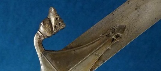

Flicking back to guns... As you say there are two places where a dragon is included in Abu Futila design ...The pan and accompanying metalwork showing a dragons head and secondly The rear sight unit....

Thank you for adding these photos Ibrahiim, they do show the dragon well, and relationship between the sword finials and pan area.
All I can say is that there is more likelihood of these barrels coming from Persia or Northern India/Afghanistan, than there is of them coming from Germany as some think, and this because of the dragon heads.
I do not know of any Germanic tradition of using dragon heads on gun parts, Other than the serpent which holds the match....and cannons at the mouth.
Having said that, Germanic and Italian barrels from the 1500's could indeed be fluted Very like these!

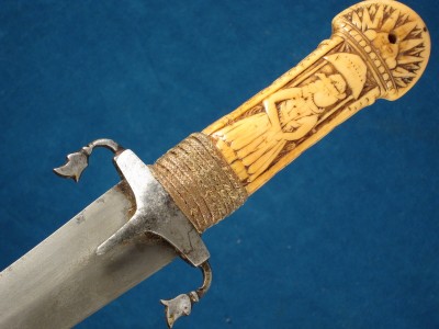

Below are comparison between pulouar finials and pan decoration;

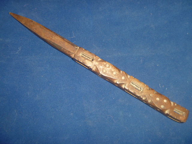

Salaams Pukka Bundook ~That is an interesting play on the geometric figure 3 on sword and Matchlock..probably Talismanic...and looking at the rest of the pan construction I see a hollow rectangle reminding me of the hollow form on Talismanic archeological nails...apparently to prevent the Devil climbing up...See #10 at http://www.vikingsword.com/vb/showth...itectural+Nail . All very interesting.
See~ http://www.omanisilver.com/contents/...ck.html:shrug:
for their rendition of MATCHLOCK/GUNS...with an exellent historical set of references on the Omani Matchlock and associated equipments..

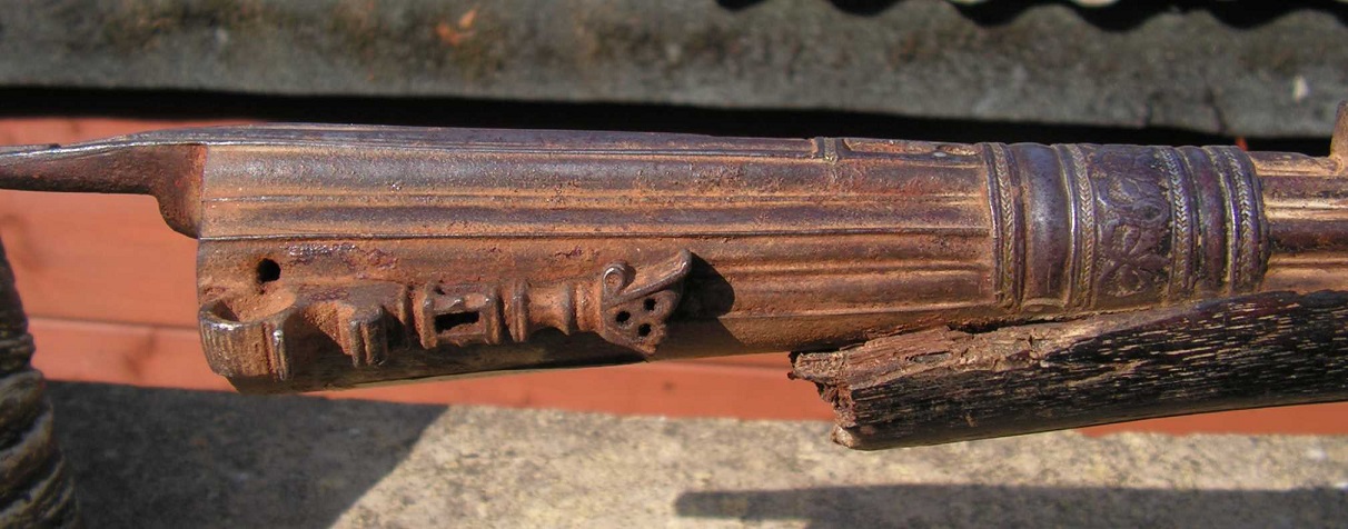

The hollow rectangle you see in front of the pan is actually cut out in both directions, so is Exactly the same as the nails you show in the other thread.
This to me removes all doubt that the barrels are indeed Persian rather than German. Thank you for that!!
There is good reason to protect the touch-hole area from evil....do not want the devil messing up your powder igniting when it counts. :-)
I have attached your 'Nail " photos for the sake of clarity. Thank you again!

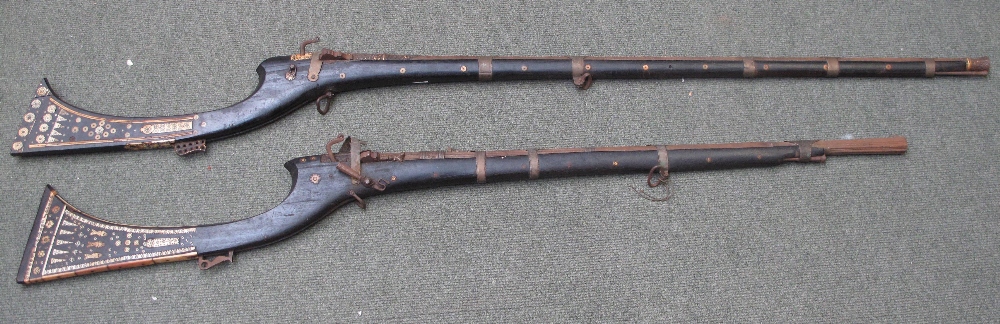

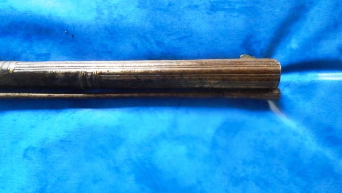

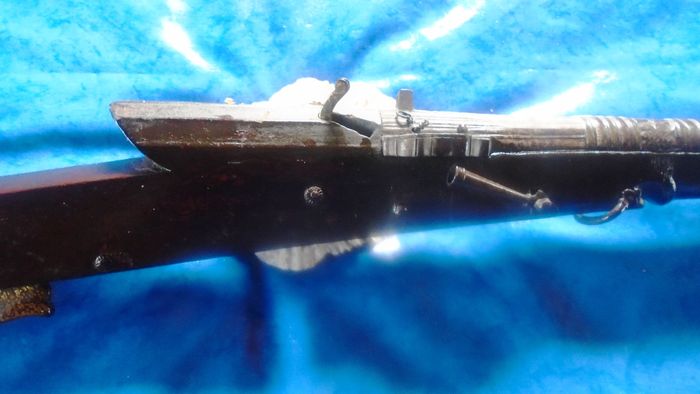

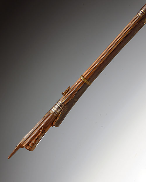

Also wish to say I have recently found more photos of this type of barrel,
One stocked up in Sindi fashion, and one only yesterday in regular Torador fashion!
Please pardon poor pictures.
