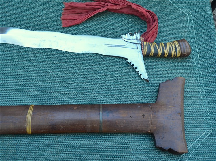

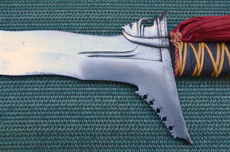

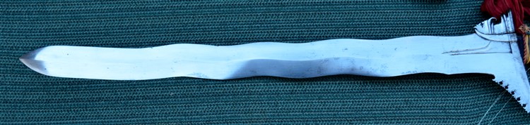

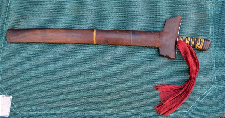

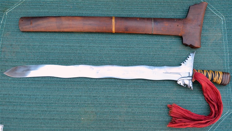

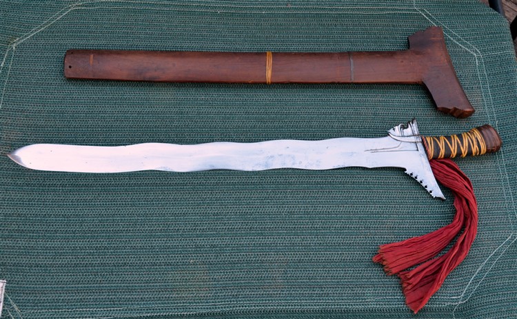

I just picked up this interesting Sundang.It is fairly large as the blade measures 24.75" and the ganja measures 5.75. " It does have a sharp luk and I do not believe the ganja to be separate from blade even though, it has been made to appear so.

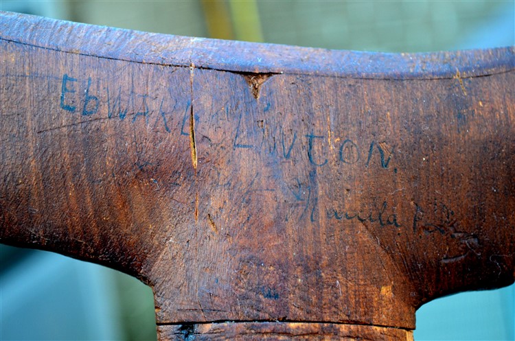

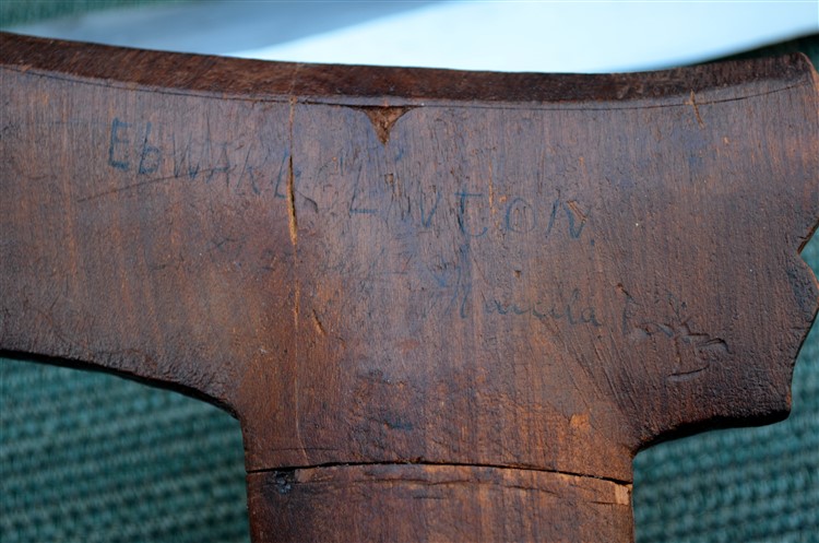

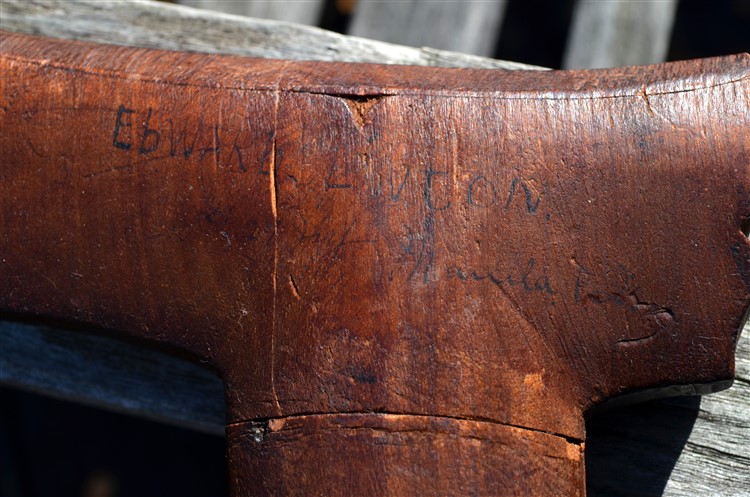

I would guess the age of the sword to be 1900 to pre-WW2.The real clue is in the faded inscription which reads "Ebwarb Clinton,-----C.G. 27, Inf.Manila P.I.," or so it looks to me.
Also, I haven't ever gotten a definitive answer to pieces of cloth attached to these swords;was it purely talismanic, was it to secure a better grip like a European sword lanyard, would the swirling swatch be used to confuse an adversary, or was it a sign of rank.
Old 10th December 2016, 02:18 PM   #2
Posts: 7,416
I would say a few things:
1. This is a Maranao kris.
2. The cloth served as both talismanic (blessed by an imam) and for wrapping the hand.
3. In the old days, to wear red meant that you had killed enemies in battle.
4. I might date this to the 1910s
5. Etch the blade. This can tell us even more.
6. Looks like an American soldier had polished this nice and bright (unfortunately). Again a good etch would bring it back to form.
7. It does look like a separate ganga by the pictures. Maybe close ups would help.

Hello Drac2k,
I would agree with Jose in nearly all points. I also would place this nice warrior piece by the turn of the centuries. That you have polished the blade bring out only the original grinding finish from the blade. Great that this blade is still in such good condition. But agree with Jose that this blade need a good etch, again, you can't make something wrong when you etch it with vinegar, it would be a shame don't to etch this nice piece. Very nice with the mansala in a very good condition. Very nice piece, congrats!

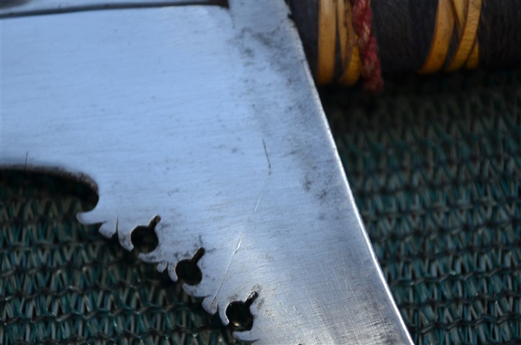

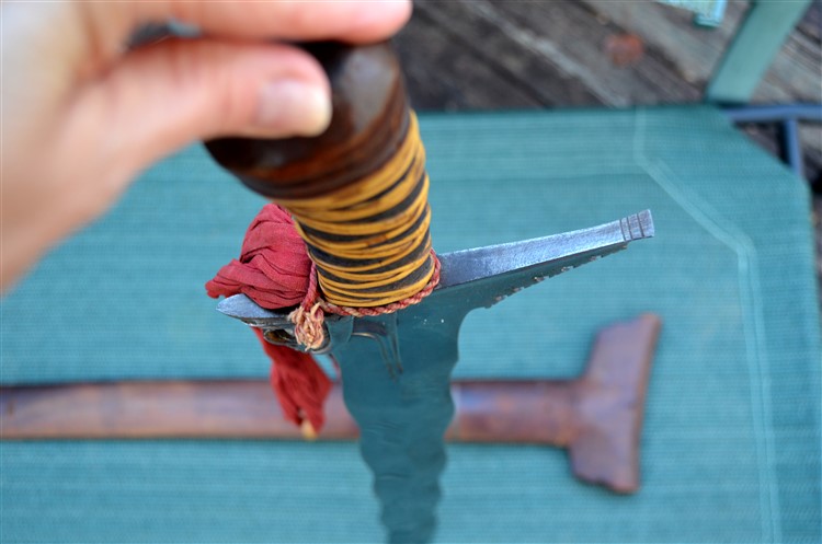

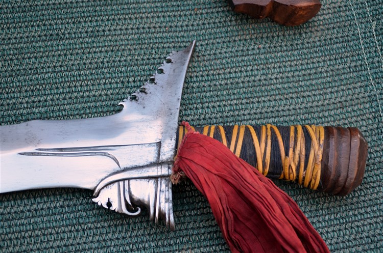

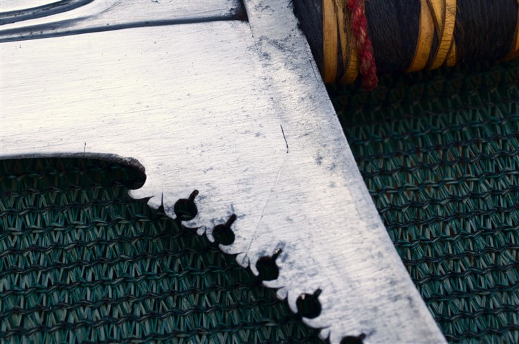

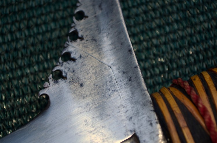

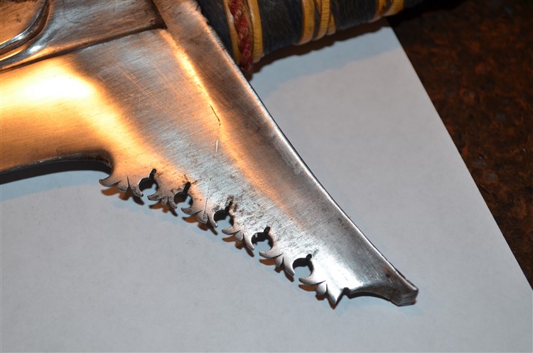

Here are some better pictures of the ganja.
Old 10th December 2016, 06:34 PM   #7
Yup, definitely a separate gangya!
I'd also believe this Moro kris to be first quarter of the 20th century or even a bit younger. Interesting arrangement of fullers at the base!

I agree with Kai - separate ganga - a great thing to have for an earlier piece. Much later do we see gangas simulated by an engraving line.
Good for you!

BTW, I'd also strongly endorse etching of this blade: Very likely laminated! And this blade is sound enough to be able to deal with a lot of etching attempts...
