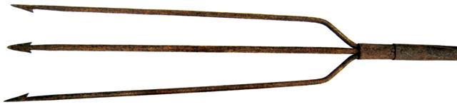

Hi Ariel,
"Sankul" or "Sangkil" is a multi-pronged spear used for fishing.
"Taming" is a round wooden shield.
"Bankow" or "Bangkaw" is a general term a spear with a leaf-shaped point
Nonoy
Nonoy Tan is offline   Reply With Quote
Old 5th October 2008, 08:02 AM   #8
Nonoy Tan
Nonoy Tan's Avatar
Posts: 293
Correction ... the "Sapang" IS the multi-pronged spear; while the "Sangkil" is a spear/harpoon with a single-barbed head. Both spears are used for fishing.

Here are two other undescribed types of spears from "moroland".
The bottom one looks like it catches fish. Unless someone knows better, the second example is a tool and maybe the first too.
