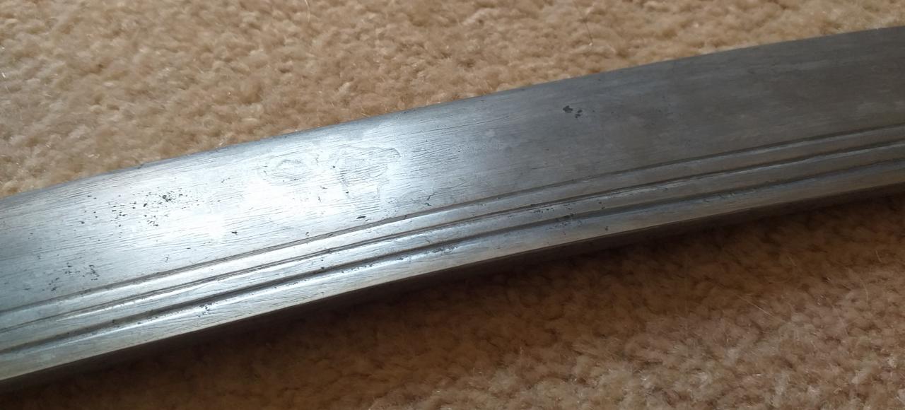

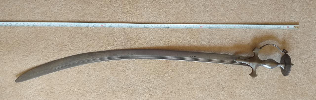

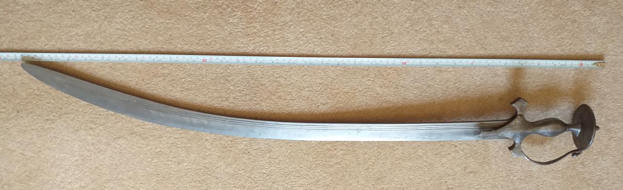

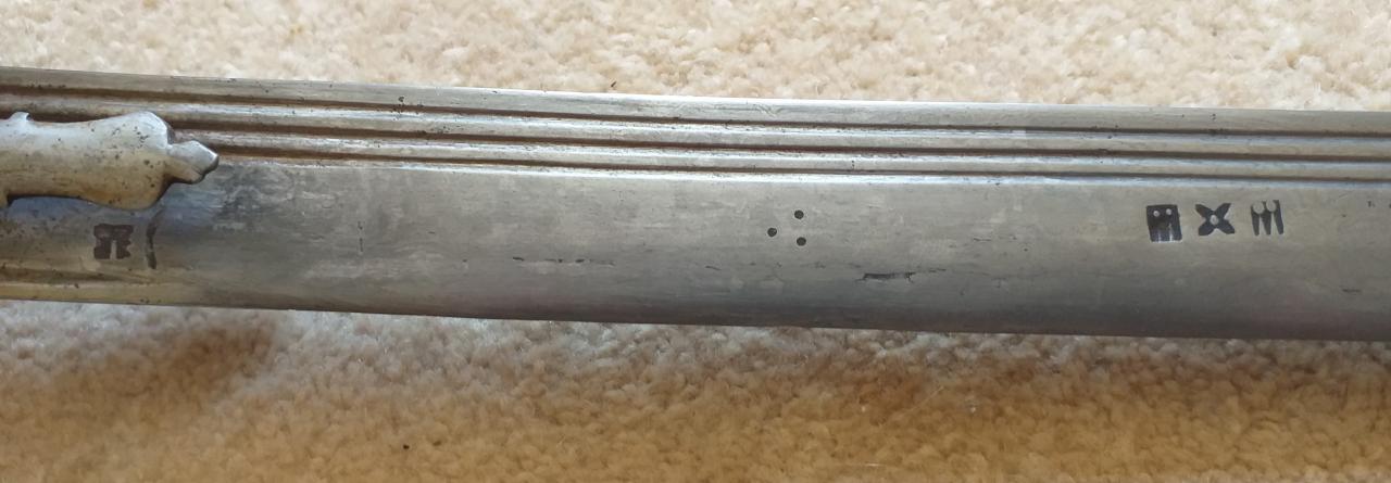

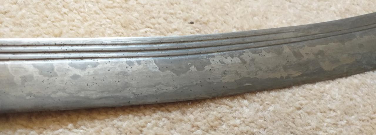

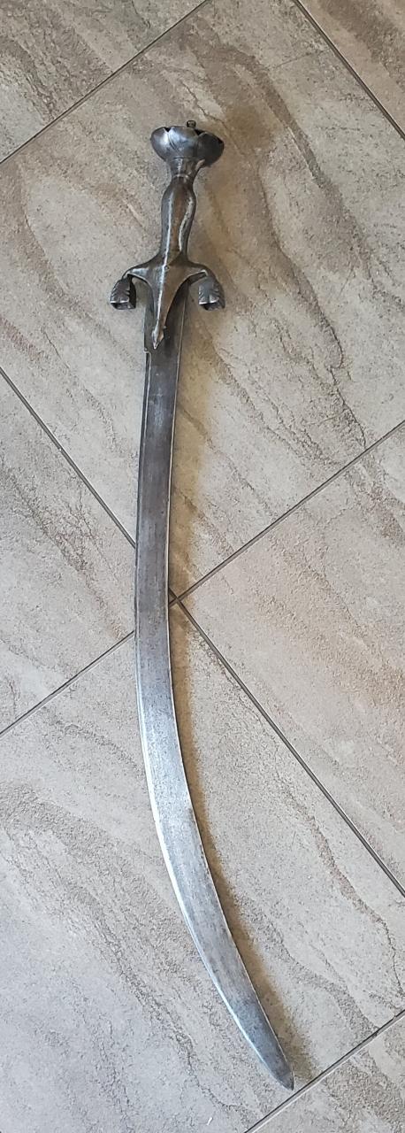

Three nice blades ,any help appreciated,the heavy kilij type blade has an interesting mark may represent a city gate,if so which one ?

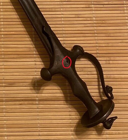

Napoleon, with all due respect I don't think you will find much information asking about these marks here. Looking at all 3 of the swords you have posted here, it is pretty clear to me that all of them are from the 19th century, based on a variety of factors, including the marks present on the blades. The thing is, by the 19th century indian sword makers had adopted a practice to show that their blades were of higher quality than the rest - by copying those markings found on european sword blades. What mattered to these smiths was more that their blades *looked* like european ones, rather than that the symbols that they used to do so actually meant anything themselves.
This is to say that, most of the marks you show in your posts here don't actually have any meaning behind them, they're just imitations of european marks.
As for the sword with the "gate" on it, I think Jim did a good job commenting on that one. The one thing I'd like to note though, is that a rivet through the hilt isn't an exclusively northern practice, but one you see quite a bit of in the south as well, particularly on tamil tulwars. In general, riveted hilts seem to be common anywhere there was a particularly heavy european colonial presence.

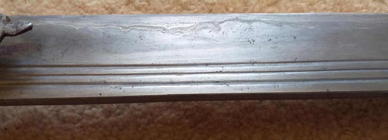

As you note, these markings are intended to imitate European markings seen on trade blades which were often quite present in India, and were more applied in the sense of 'quality' or 'power' so they were not 'artistically' rendered necessarily. It was the implication of what they imbued.
Although on this tulwar, can be seen three dots.

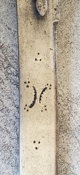

One of the highly copied European markings are the dentated arcs known as sickle marks or Genoan marks. These opposing arcs usually had three dots at the terminus of each arc. While it is tempting to suggest these dots seen on this blade might be from those, it should be noted that many tulwars have these three dots seemingly strategically placed at key places on the blade but alone. There is a suggestion this may have to do talismanically perhaps with the Trimurti, but difficult to elaborate further here. One of the most common markings of the sickle mark kind and similar blades seem to be on Afghan 'paluoars'.
The marks that seem to be imitated here appear to be the so called 'twig' type marks on Italian blades, but difficult to say for certain.

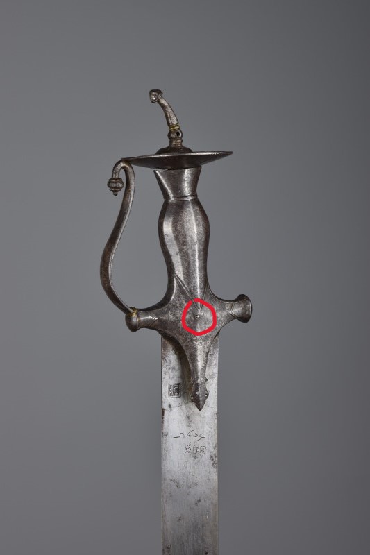

Speaking of a possible connection with Tipu Sultan, one of my examples (the one with the grey background) actually has a mysorean armory inscription on the blade, so it's certainly possible they had an affinity for riveting their blades as well.

I suppose I should probably note that not all of my attached examples are of tulwar hilts specifically, but my intent is mostly just to prove that these hilt rivets can be found on south indian arms in general, not just north indian ones.

First of all, while the centrally riveted cross guard on tulwars of Afghanistan and its northern environs is somewhat intrinsic in the hilt designs of these regions, it is not necessarily confined to nor entirely consistent in these areas. In looking further into this type of feature as far as its use elsewhere in India, it is important to consider that an evident rivet so placed in a hilt is most often the result of refurbishing of a weapon and securing the hilt. These processes and such placement of a central rivet in the guard therefore are widely known, and my suggestion that this feature had a distinct regional classification was incorrect and invalid, as would it be to presume it would apply in that manner anywhere overall.
Often it may be considered that such a fixture might suggest refurbishing of a weapon completed as a 'field repair' or by someone not necessarily highly skilled in finer metal work.
