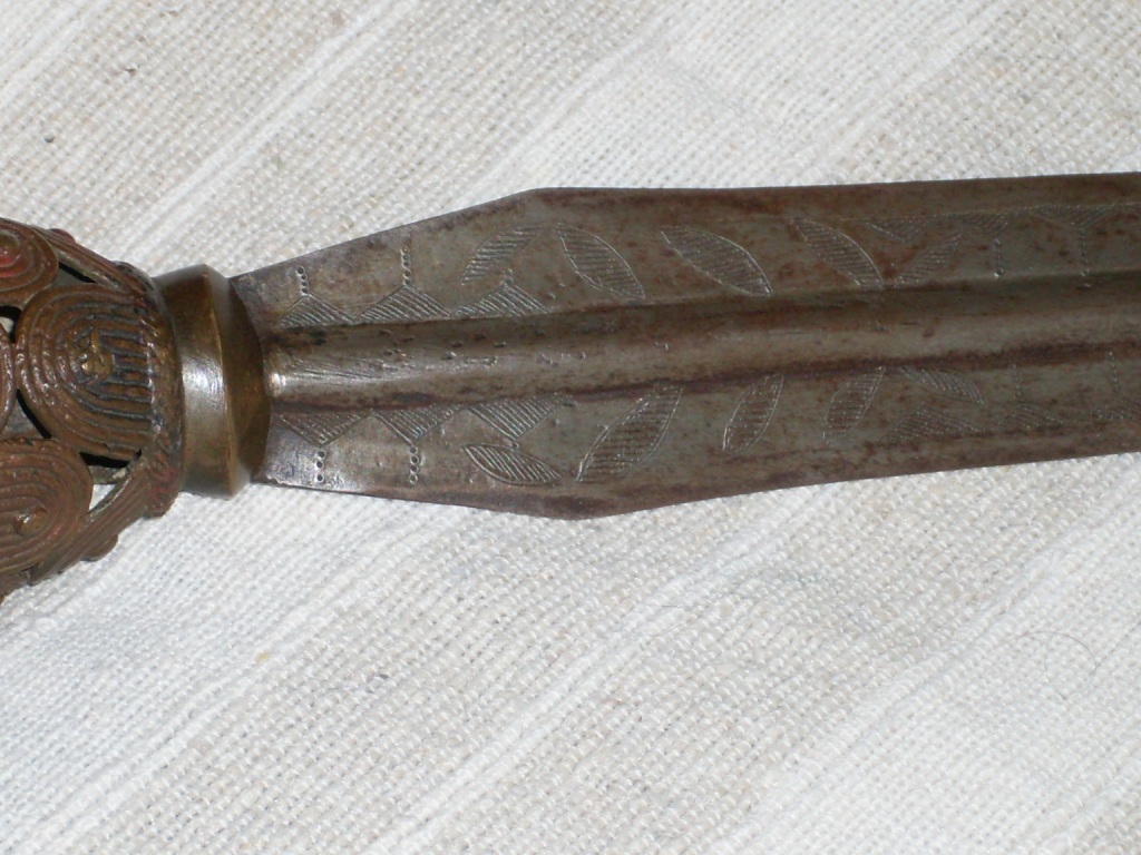

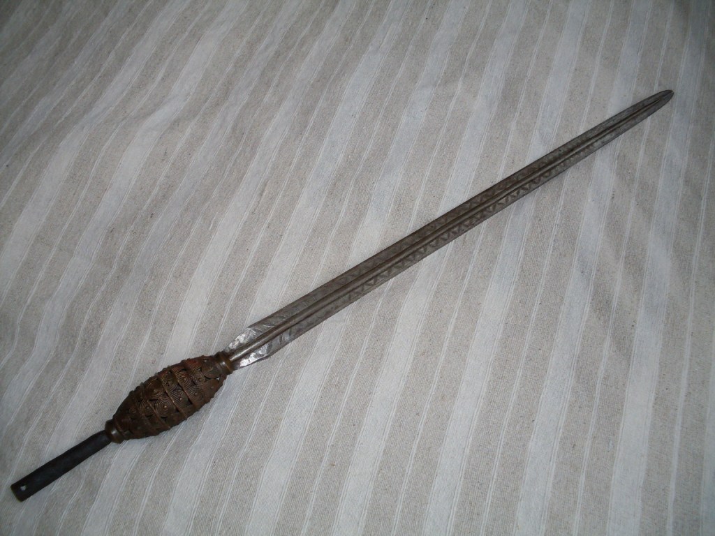

Hi, I just found a Kaskara with the enigmatic marking from Briggs 1965.
The marking is present on both sides, no other stamps visible.
Plain mountings, I guess late 19th, early 20th C.
Blade however seems older.
A different text on both sides of the blade. I guess Quran verses, but probably also a date or reference to someone or something.
Any help is appreciated.

It is always exciting to see 'kaskaras' brought in here!!! and very nice example with old blade and of course the commonly seen remounting as per the generational upkeep of these older blades. It is always hard to determine the vintage of these scabbards and grips, but the guard and pommel seem early 20th.
Getting of course to the blade, it is unusual to see the panel in Islamic script, which if I recall correctly relate to the 'Lohr' panels on devotional items in the Muslim Faith, but I am not well versed enough to elaborate.
