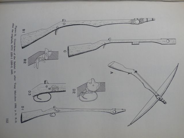

- See Material Culture of the formosan Aborigines , by Chen chi-lu.
PP152 153 154
To sum up what's in the book: Crossbow is found in Formosa only among the Tsou and Saisiat tribes; no more in use among Formosan tribes; it is a mainland culture trait ; introduced by Chinese settlers and diffused to the mountain tribes; in general, the crossbow appear to be a combination of bow and blowgun, what is confirmed by the facts that crossbows darts were often used with poisoned tipped - something that didn't diffuse into Taiwan together with the crossbow
See the drawing from Chen chi-lu of a Saisiat crossbow in the collections of the Nat. Taiwan Univ.
