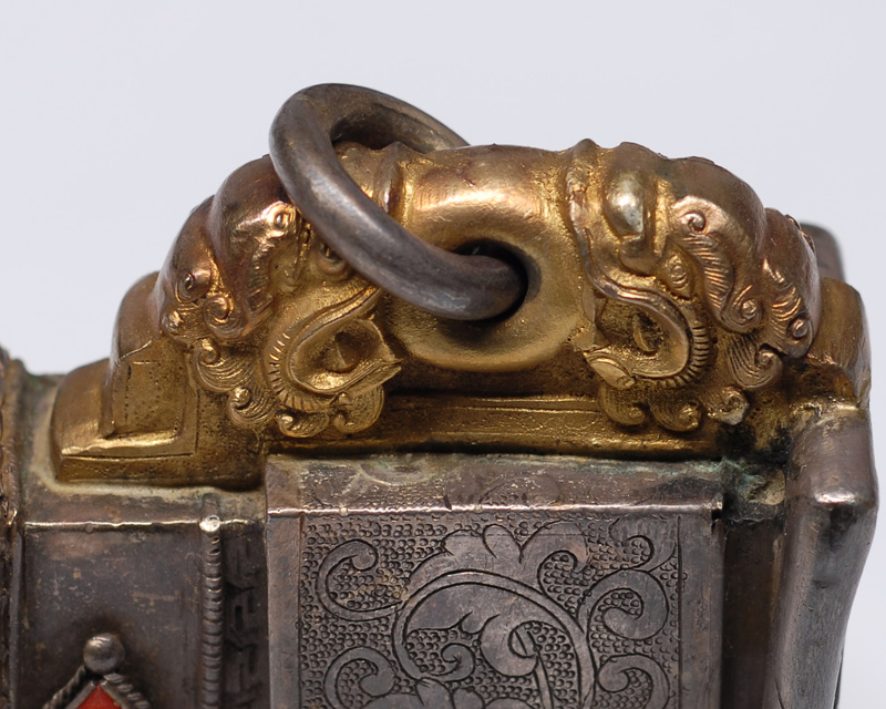

Greetings Everyone! I’ve come to this forum hoping that someone can shed additional light on this sword I have. I’ve taken it to an appraiser and have posted on one other forum that specializes on Asian Antiques. I’d like to hold off on opinions I have gathered so far but will tell you the jade pieces real. I’ve also included a photo of a “Certificate of Authenticity” but have found that opinions vary on acceptance of such documents. Look forward to everyone’s thoughts and thank you in advance.

who cleaned it? no wear, no patina? where has it been if it's over 100yrs old? picture of it outside the scabbard & of blade please. i personally am a bit sceptical of real 'antiques' from china as their export is illegal.

I'd be interested to see the blade. It's not impossible that genuine antiques do come out of China. I had a number of years ago a very rusty composite jian with similar certificate. As I didn't have the time to restore it I passed it along to another collector who had it assessed by two experts and it turned out to be possibly not even Chinese but likely 17th century.
So strange things can happen. Unfortunately with this one I'm somewhat doubtful, it looks very clean.

Welcome to the Forum, Cmario88.
I resonate the above concerns. There are no visible signs of wear and tear, which is usually associated with old swords, even if they were ceremonial like yours. Posting the close-up of the blade will help. In addition, that appraisal is very vague. It states that the jade, corals, stones and silver are old, which is totally meaningless, as it refers to raw material:-) The work, however, is in question, it looks too fresh. Also, do you know that the date of this paper is authentic, i.e. 1976? When it comes to Chinese "Certificate of Antiquity" - even the paper can be new:-)

Welcome cmario88.
I to agree to this not being older than 1970.
My opinion looking at the images is that it is copper formed that is plated in low quality gold and silver, look close to the suspension fittings and it shows to my eye the gold incorrectly going over the silver...almost like it was dipped.

The certificate is exactly saying what it is :
‘This sword is … from the xxxx dynasty and dating from xxxx’’
There is no dynasty and no datation mentioned.
Only it is said it is older than 100 years old. But here is the trick, and the certificate is exactly explaining what it means :
“ the jade coral and turquoise are over 100 years older ‘’
Nobody will dare doubt that stones are older than 100 years old. Perfectly true.
Well, authentic certificate. The thing is what to understand when reading it.
Yes, this is an authentic ‘antique’ sword, ‘antique’ to be understood as ‘old”. This sword was certainly old when it was sold (may be few years or few months old in the 1970s). It is now even older, a quarter of century after ! There is no patina, no sign of use and the artwork is quite crude, but I can now certify that this sword is from the last century !

What's with the stain/ discolouration on the blade? This looks chemically treated somehow to me. With so many 'antique' swords being made in Guandong on a daily basis and sold to unsuspecting round-eyes, it's difficult not to be sceptical about edged weapons coming out of China.

Nothing about this piece really "adds up". First off, this "Certificate of Authenticity" is issued by a merchant's association in Hong Kong. Not by a legitimate and accredited museum, or the Ministry of Culture but by a ... (ahem!) group of guys who are in the business of selling antiques, tshatshkes, curios, and the like to whomever would buy them. In the Shoppers' Paradise of the Orient, no less. Yuanzhumin has hit it on the head in his post: this document is a pot that won't hold water.
The shape of the blade has no relation to any jian which I have seen from the Han Dynasty onward. The notable reduction in width as it approaches the rather acute tip is a contour that is taken from the classic bronze swords of the Zhou Dynasty's Warring States Period. Yet this blade is made of iron or steel, and has a simple lozenge cross-section (as is the case of jian made during the medieval and late imperial periods), without the complex bevels, sunken panels, and ridgelines in relief that are characteristic of the bronze blades of classical antiquity. The fellow who conceived this blade tried to cover the span of history in one blade and as Genghis Cohen might have said, "me ken nisht zitsn af tsvey shtuln mit eyn tokhes".
The fittings are likewise a stylistic mishmosh. There are these gilt bands with archaistic elements in relief, as seen on Shang and Zhou bronzes. The chape is patterned after those on jian scabbards from the Zhou and Han periods. Next to the gilded elements is silverwork with motifs similar to those seen on Tibetan objects (such as knife-sheaths, tinder-pouches, bowls, pitchers, etc.), with the characteristic turquoises and corals.
I first saw these in Hong Kong in the 1970s, shopkeepers all said at that time that these were "Mongolian knives and swords". One problem -- in all of the period photos I've seen depicting Mongolia and its people, not one of these swords shows up. The Los Angeles County Museum of Art has a single-edged example which is captioned as "Tibetan" in the display cabinet. Again, an exhaustive hunt for documentary ethnographic photos, or provenanced examples in museums, has turned up zilch. And interestingly, nothing remotely similar was included in the definitive exhibition "Warriors of the Himalayas" mounted by the Metropolitan Mus. of Art in 2006 using material from collections in several countries.
These are curio items, composites made of associated materials : antique jades and other hardstones of varying age, blades which were either freshly made (usually quite crudely) or recycled from broken antique Chinese and Japanese swords, and silver parts crafted for the purpose. It's believed that most of these came from Beijing. Silversmiths there were familiar with Tibetan styles of silverwork because a fair amount of the metalwork used by Tibetans was in fact made in China for the export trade.
Some of these sword-like objects are "fairly old" because I've seen a few which have a provenance of sorts -- estate pieces traceable to military or diplomatic service (usually as gifts to US personnel in China before or during WW II). One piece of this sort I remember seeing at a gun show was a jian that had virtually no patina to speak of (having been well-stored in a gun case for years) and fake Qianlong reign marks on the blade that were something of a bad joke. I also saw brand-new ones for sale at the Beijing "Friendship Stores" in 1979 and '81, and similar albeit poorer-quality ones offered for sale in Shanhaiguan in 1998.
