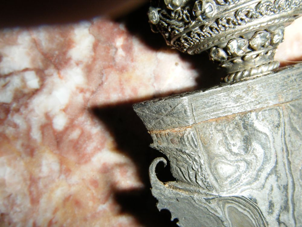

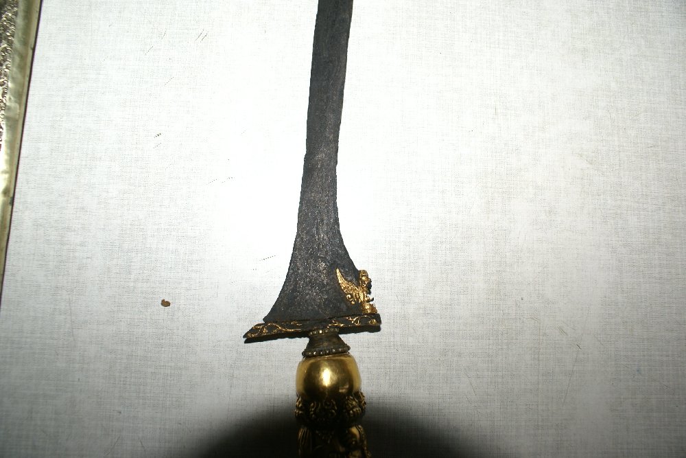

Hi Moshah,
yes, I think that this is original. What I have seen until now is that the way of kinatah work on Sumatra is different than on Java or Bali. Look for example my blade in the link in up. Here a picture from the Sumatra blade where all gold is missing, you can see how the gold have been affixed before. And a second picture of an very old Madura blade with kinatah.
Sorry, the first picture is the Madura blade and the second the Sumatra.

Posts: 171
You mean, the kinatah from Madura and Java is bold, while Sumatran style of kinatah is like a simple gold overlay (like a watercolour painting)?
BTW, nice kinatah on your Madura blades!
Moshah is offline   Reply With Quote
Old 12th November 2009, 05:26 PM   #9
Thank you for the compliment of the Madura blade.
No, I mean that the kinatah from Sumatra isn't so strong attached like by Java or Bali blades. This is what I have seen by my both blades and some other blades. Would be interesting to read the knowlegde from other members.
