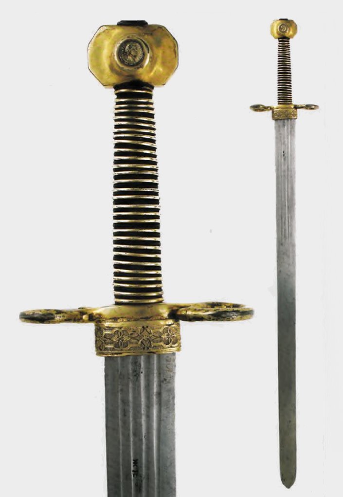

Here is another distinctive sword in the Hungarian National Museum. The oblong octagonal pommel is similar to previous examples, but of higher quality with an inset emblem (possibly a coin?). The blade is again type XXb. The quillons have extended from an S-shape to a closed figure-8. Probably this coincides with the development of the famous German katzbalgers in the 16th century. The hilt has another cuff-like metal "rainguard" as seen on other presumably Hungarian swords posted above.
Name:  Budapest, MNM, 55.3212.jpg

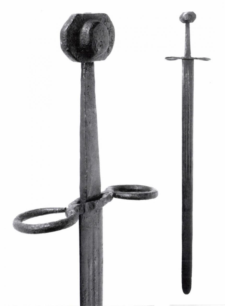

The museum has another very similar but much plainer example.
Name:  Budapest, MNM, 53.323.jpg

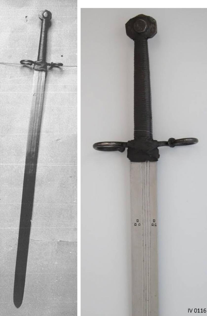

An overall very similar sword comes from the Dresden Armoury. The multi-fullered blade is stamped with distinctive knot-like marks that suggest an Italian origin, perhaps Belluno specifically. The marks on the first sword are likewise Italian in style.
