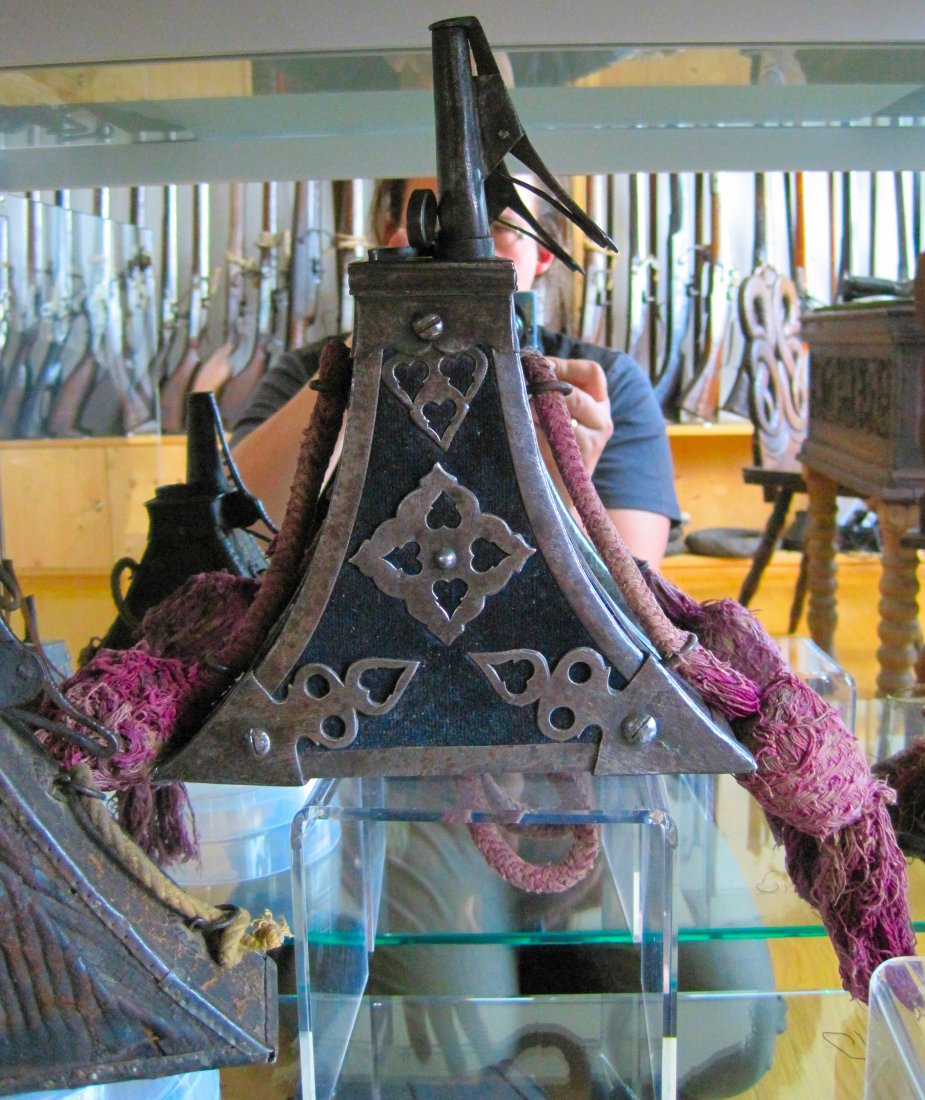

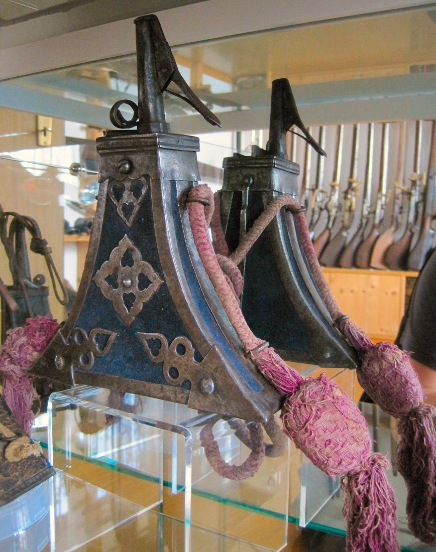

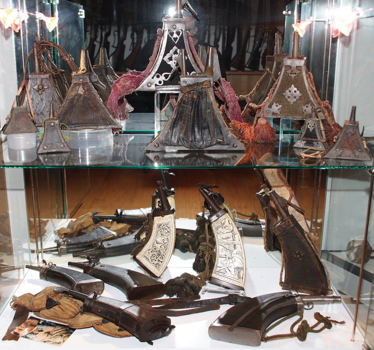

I attach photos of similar flasks in my collection; the first an unusually fine and large specimen, Nuremberg, ca. 1580, the body covered with blue velvet, and retaining its original colored wool and silk tassels.
