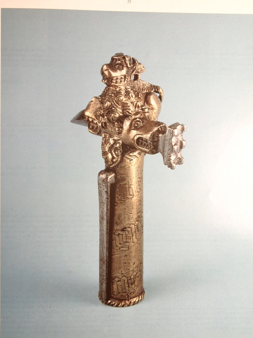

I knew that my remembrance has not abandoned me!
It was for sale at Christie's February 1991 lot 43 with an estimate of GBP 12.000, but is not listed in the result-list.
The height is 165mm, the spike has only a length of c. 23mm till the monsters mouth. This would be enough to penetrate plate, but not to cause serious injuries. Therefore I believe it is a splendor-hammer, not used for fighting.
You know that there are hundreds, if not thousands of two handed processional swords of the 16/17th century, not used for fighting. Surely some processional items from medieval times have also survived. The high quality also indicates that this was a splendor-item.
