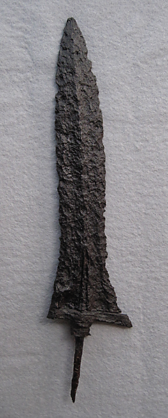

Here is an image of a genuine keris budho.
Mick's image also gives a good impression of what they look like. This example is just under 12" long from blade tip to pesi tip.
However, it is necessary to allow a reasonable degree of latitude in assessing whether a blade is genuinely a KB or not.
Erosion can alter the outline of the blade.
Some blades display quite refined features, others are basic.
Based upon my personal observations, I am not yet prepared to dismiss all apparently archaic blades that show some evidence of pamor, as forgeries, false, or creations designed to decieve. Yes, such creations do exist, but the pamor effect can be found in other forms of archaic blade that are not keris blades. Additionally, I am of the opinion that production of blades in the budho form continued well past the Early Classical Period, and probably they were still being produced into the 16th-17th centuries, a period far too early for production to occur for reason of the deception of "tourists" and collectors.
Genuinely archaic keris budho also occur in bronze.
