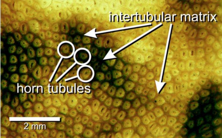

cpkaway2 29th February 2016 06:12 AM
1 Attachment(s)
This photo illustrates the point made in message #4. I found it on the https://www.antiquers.com website with the caption: “If you can find an end, the end grain may look like this. Rhino horn is in fact a mass of hair bonded together.
Battara 2nd March 2016 01:11 AM
Very nice example, thank you!
