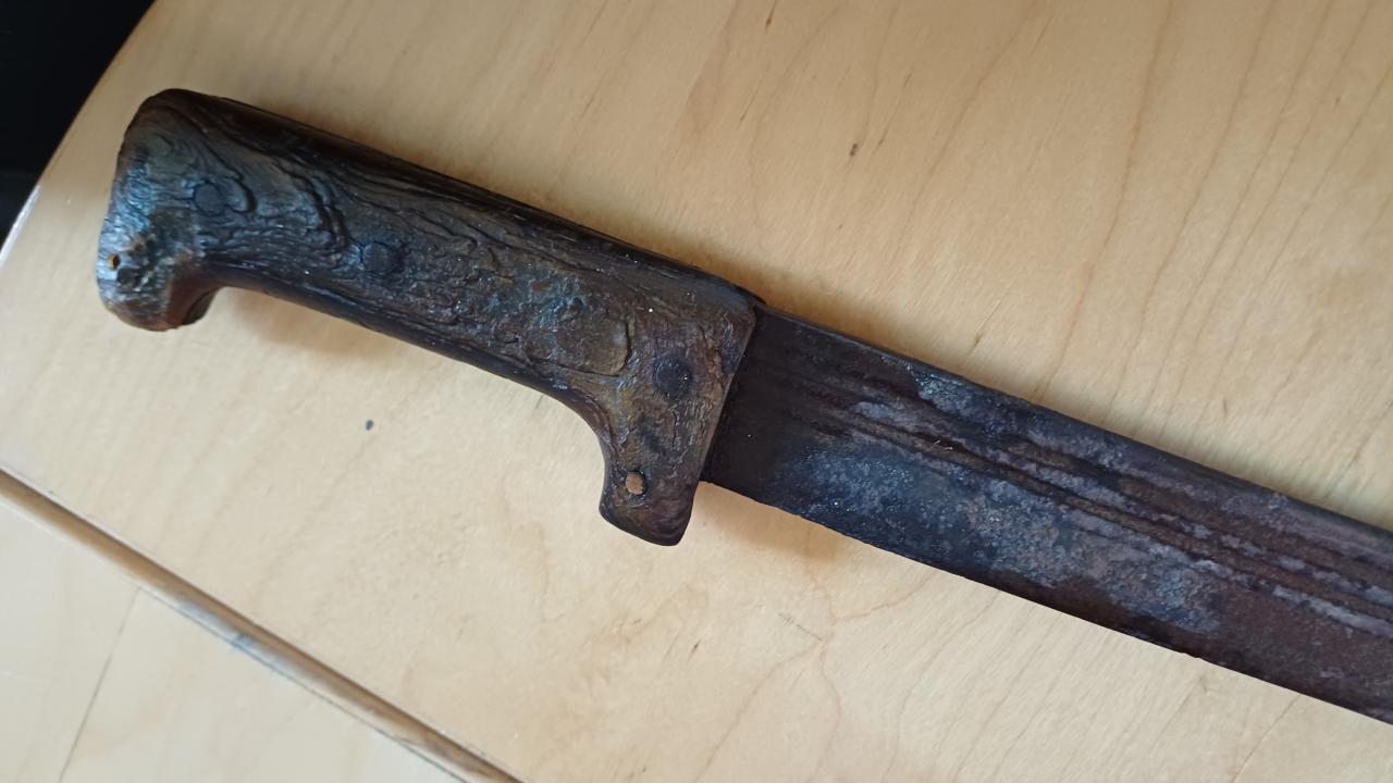

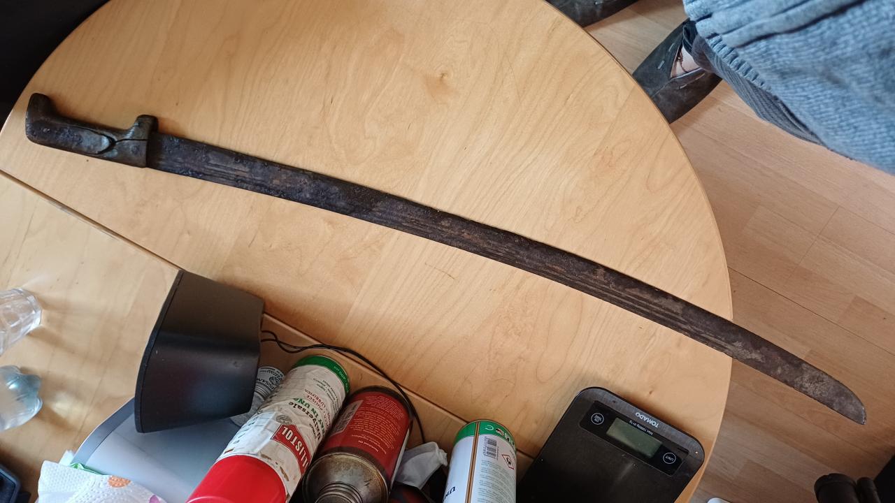

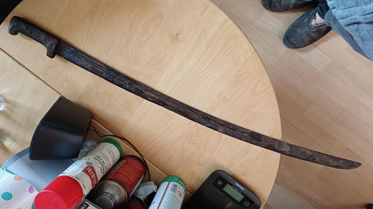

Picked up this very worn sword for the price of a pizza and a half.
Attachment 251828
Attachment 251829
Attachment 251830
It has the typical triple fullered blade you see on Moroccan nimcha and lots of other swords from around the world and horn grip scales. The shape of the grip looks a lot like those of Bedouin swords, but it's missing some of the decorative elements that are typical for the group, so I'm not quite sure. Do you think this is an accurate identification?

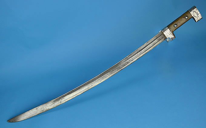

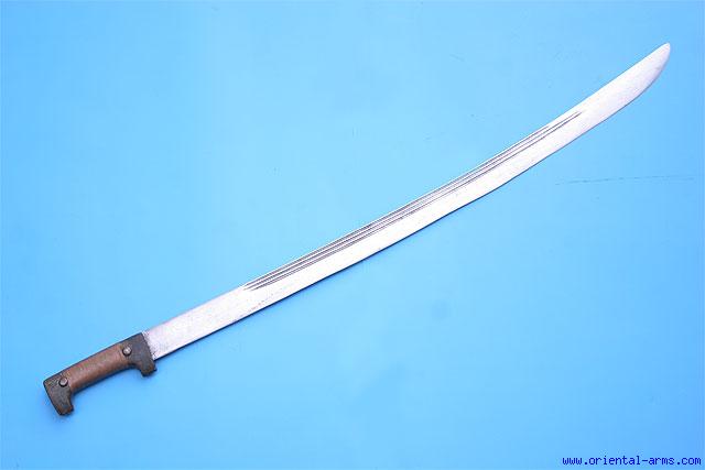

For reference, here's the type of sword I'm thinking of:
Attachment 251831
Attachment 251832
Sajen 26th March 2026 03:20 PM
Hi Nathan,
I am far away from being an expert on these swords but I think that you are correct with your attribution! You will have a lot of work with cleaning the blade! ;)
Bob A 26th March 2026 04:29 PM
Nice find, but as the interminable cleaning process grinds on, you may wish you'd opted for the pizza.
Jim McDougall 26th March 2026 05:52 PM
I likes em as they are! rough,
This seems, by the hilt style, to be Bedouin alright, and of forms in Sinai Peninsula, but of course hard to be exact.

Pertinax 26th March 2026 10:35 PM
[QUOTE=werecow;302787]Picked up this very worn sword for the price of a pizza and a half.
Congratulations, a very interesting subject. And the chores of cleaning always bring pleasure.:D

werecow 26th March 2026 11:53 PM
Thanks all! Nice to have that confirmed. I already soaked the very dried out grip in neatsfoot oil for a day but a large chunk has started to peel off, as you can see in the pictures. Not sure what I should do there. Just leave it be, or...?
As for the blade, I will give it an initial light cleaning to get rid of active rust and will save the rest of the work for when I can sit outside. :cool:

werecow 27th March 2026 01:55 PM
1 Attachment(s)
One more question. I want to stabilize this bit of horn that is sloughing off on the grip so that it doesn't get worse. I was thinking of just putting a few drops of glue in there to fill up that crack. Is that an acceptable repair? And if so, what glue is best for antique horn?

Sajen 27th March 2026 11:49 PM
I would use a two-component adhesive and a zip tie to hold it in place until it's dried.
werecow 28th March 2026 01:56 PM
Alright, that seems sensible enough, thanks!

RobT 1st April 2026 01:13 AM
Dry Clamp First & Use A Clamp To Glue
wildwolberine,
Before you do the glue up, dry clamp it first. Make sure you use wood pads (known as cauls) to protect the hilt from the hard steel jaws of the clamp. If the part of the hilt that is separating can be drawn back down fully, you are ready to glue up. When you apply the glue (all crafts 2 part epoxy is my favorite), use as little as possible to make sure that no glue will squeeze out to become visible when the clamp is applied. I would recommend using a clamp rather than a zip tie because the clamp can provide far greater pressure. I would probably opt for one of my Jorgensens but even a c-clamp will do.
Sincerely,
RobT
