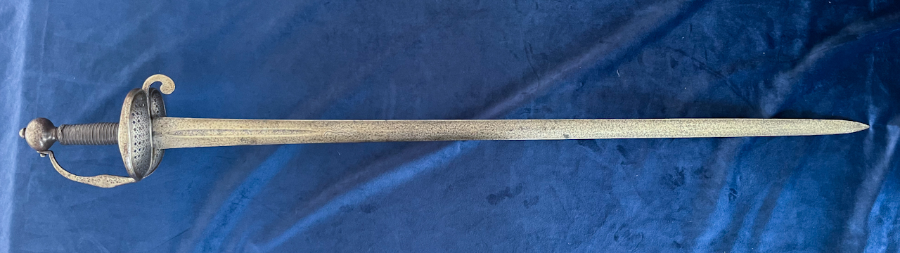

Hello all, I'm trying to find more history on the so-called 'Amsterdam Town Guards' Walloon sword.
Attachment 227869
Attachment 227870
Generally speaking, the term 'Walloon sword' is now applied to a broad range of swords typically characterised by its distinctive hilt, which features asymmetrical discs for the guard, a knuckle bow, spherical pommel, rear quillon and often one or two side branches to form a basket hilt.
The 'Amsterdam' swords vary from this type by having only the single knuckle guard, a distinctive perforated guard, where the holes are decorated to look like small stars or suns. It is believed that these swords date back to between 1650 and 1700 and are unique for the uniformity of their design. The bulk of these swords feature a 36-inch (92mm) broadsword blade and are believed to have been used by the cavalry. Occasionally swords with shorter blades do show up with claims that they were for infantry. But I have to wonder if the blades have not been shortened in the last 300 years. The same holds true for when these is a backsword on one of these hilts... How do we know this is the original blade?
Attachment 227873
Attachment 227874
Attachment 227875
Originally these swords were believed to have belonged to the Amsterdam city militia because they are almost universally marked with the Amsterdam Coat of Arms:
Attachment 227871
Attachment 227872
However, too many of this type have survived for them to have been exclusive to a city militia. Another theory goes that the French captured several 'walloon' swords in their war with the Dutch in 1672-1673 and called them epee wallone based on this design, French King Louis XIV in 1679 ordered that his cavalry be armed with a specific sword based on this type. If correct, it would represent the first official French pattern sword. The rationale behind the Amsterdam stamp, is that the order went through the cities' guilds when Solingen refused to deal with France at the time.
This argument is made in the French magazine; Gazette des armes No. 473 March 2015
Another possibility is that these swords were supplied to the standing army of the Province of Holland, of which Amsterdam was the economic capital. In the 17th Century, The Netherlands was a republic of seven Provinces. Rather than having one unified standing army, these provinces each would have supplied and maintained their own levies under their banner in times of war.
I think the presence of the Amsterdam stamp is key in this puzzle. Is it unique to these swords, meaning it could be a Pattern specific to the Holland provincial army. Or was the mark applied to other swords indicating that it was a commercial guild mark of the Amsterdam guilds (who wielded a lot of influence at the time).
Has anyone encounter the three XXXs on a crowned shield on any other type of blade?
(For cultural reference, to this day the XXX motif can be seen everywhere one looks in the city of Amsterdam.)
