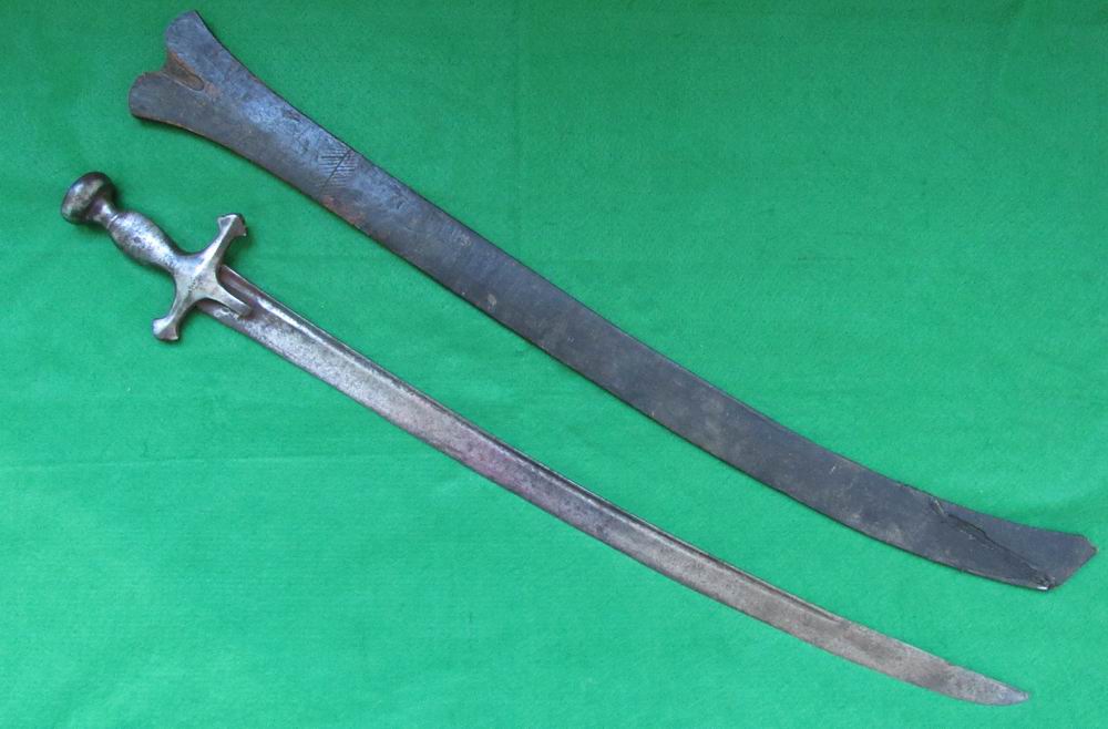

Lew 11th June 2006 01:54 PM
1 Attachment(s)
Originally Posted by Dajak
Who can tell me the difference
Dajak
I far as I know piso-padangs if I am spelling it correctly are Batak. Here is a picture of mine for comparison.
Lew

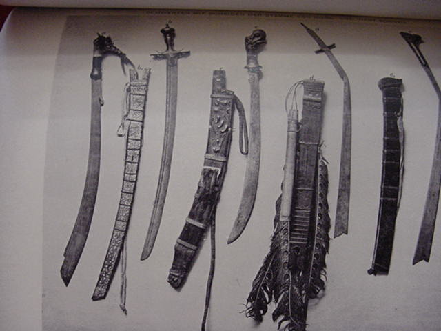

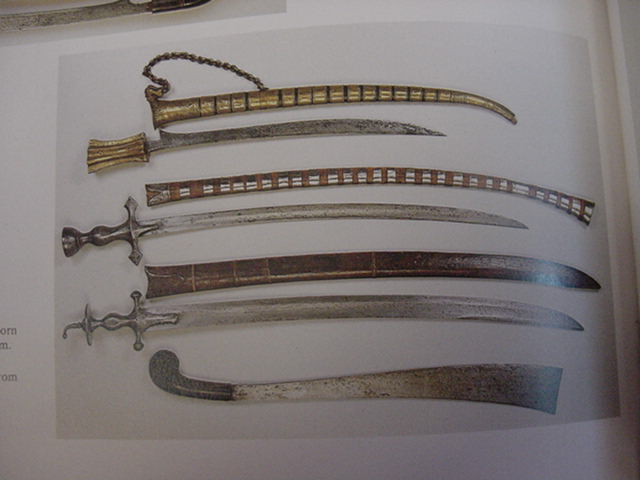

9 Attachment(s)
Hi yours looks more a batak sword than the one from vvv
here are some pics that show a dajak batung lupar that did use these swords too
And some pics from an Batak book
