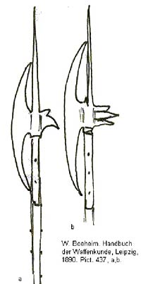

2. As regards the term "godenak", I've selected some fragments from the Maciejowski Bible (1-9 enclosed) and several quotations:
Godenak - "Medieval Chopper". On the images from the Maciejowski Bible we can see a heavy chopping blade, having more or less marked cogs on the upper part of the butt and a moderate contracurvature of the chopping part of the blade, which was only used by common people. It slightly reminds of the Nepal sword "Kora", having a deeper contracurvature.
Godenda, godendag, godendac (Stoun, p.248). A Flemish halbard of the 12th century.
Godendag - Streitaxt (battle axe) (W. Boeheim. Handbuch der Waffenkunde, p. 369, pict. 437 a, b.).
A Flemish weapon, descending from axe, - a sort of halbard.
[This message has been edited by Lee Jones (edited 12-27-2002).]

In David Nicolle's "Arms & Armour of the Crusading Era 1050-1350" he has reproduced with a line drawing a staff weapon from a mosaic at the Cathedral of Montreale Sicily. It is near identical to the one held in the top picture (except on a pole, and the hook is slightly larger). The weapon is held by one of the guards at a crucifixion scene. Nicolle calls it a "war-scythe". The painting is circa 1180-90 and was for the Norman rulers of Sicily at that time. This fits nicely with the above discussion.

"It does seem to me that medieval European illustrators got rather imaginative in depicting foriegn troops, and that may have something to do with these blades."
This is true but I believe that the people holding those weapons where representatives of "good"(ie. the home team). They probably represent real weapons. Perhaps a early (crude) form of the Falchion?

I have asked Lee to post a picture from Queen Mary's Psalter. I suspect the knight on the left is Mr Pottinger's inspiration. it clearly is a hand weapon here as well.

It looks like a Falchion or unmounted pole arm to me too.Look at Stone p224 & 226 as well.
