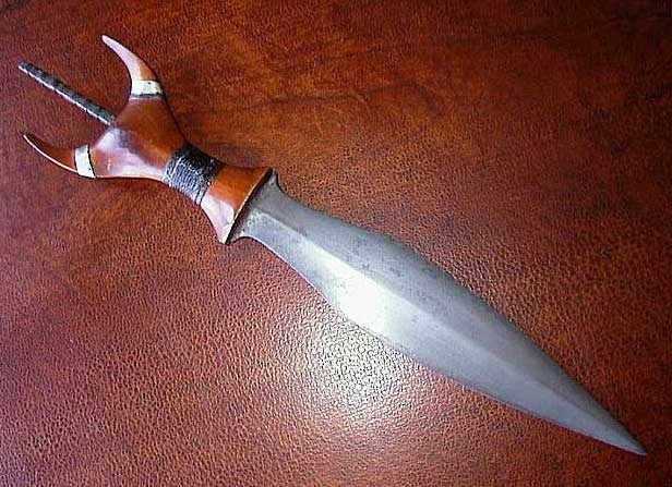

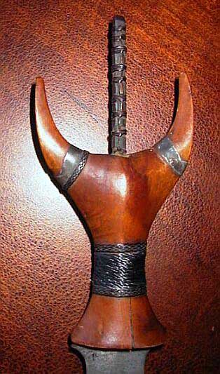

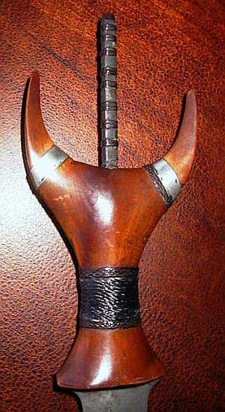

And here are pictures of the dagger in an earlier post.
image restored from archive
THE DAGGER AND ITS SHEATH
"A weapon, whose distribution is limited almost exclusively to Manobos south of 8 degrees of latitude, is the Mandaya dagger, of Mandaya workmanship, and indicative of Mandaya influence.
Its component parts are a thin laminated piece of steel from 15 to 25 centimeters [6 to 10 inches] long with a thin, tapering rod somewhat shorter, projecting in the line of the axis, and a hilt of banati through which the projection of the blade passes. It is carried in a sheath which is held at the wearer’s right side by a girdle.
The blade is two-edged, widening from a sharp point to two shoulders from 3 to 4 centimeters apart [1.2 to 1.6 inches], whence the edges incurve gradually and finally end in two projecting spurs 3 or 4 centimeters apart. The rod for the reception of the hilt extends from this point along the line of the axis for a distance of 6 to 8 centimeters [2.2 to 3.2 inches].
From time to time one finds a blade that is inlaid with tiny pieces of brass or silver, but there is never any kind of ornamentation.
The handle is of a type that is unique, as far as I know, in the Philippine Islands. In using the dagger the body of the hilt is seized in the right hand, the index finger is inserted between one horn of the crescent and the central steel tang, and the thumb between the latter and the other point of the crescent, while the other three fingers hold the weapon within the palm. This method seems clumsy but nevertheless it is the orthodox way of holding it. Fastened to the right side of the wearer in a more or less horizontal position and with the handle projecting forward, it is always at the owner’s disposal for prompt and deadly action, especially so as only a mere thread or two of abaka fiber running from the handle to the upper part of the sheath retains the weapon in its sheath.
The handle is usually strengthened at its neck with plaited rings of nito fiber and may have ornamental silver work, both at that point and on the horns, or even at times on the whole outer surface of it.
The sheath consists of two pieces of wood of an elongated rectangular shape, spreading out at the extremity. Strips of rattan wound at intervals hold the two pieces together and a paint of blended beeswax and pot black is ordinarily employed to give a finish to it. But occasionally one sees bands of beaten silver at the head of the sheath, and, less frequently, a profusion of beautiful, artistic silverwork set over the whole sheath."

Vandoo:
Alas, the dagger is not mine but belongs to our esteemed Moderator (Rick). I simply borrowed the picture (via URL) from an earlier post here. In that post, the materials are discussed by Rick and others.
Ian.
