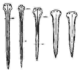

Middle Bronze Age- Early Bronze Swords (Rapiers)
Rapiers were used as thrusting or stabbing weapons, which may seem odd, as thrusting swordplay requires considerable skill, while slashing is an easier and more natural style of warfare [Oakeshott 1960:34]. However, the use of this kind of sword as a thrusting weapon is "a result of its weakness and inadequacy, not a manifestation of skilful swordsmanship" [Ibid.]. The argument for this is that the hilts of rapiers were attached to the flat shoulder of the sword by rivets. This meant that the sword could only effectively be used for stabbing for "if lateral strains were put upon them there was little to prevent the rivets pulling sideways through the thin bronze" [Ibid.:26]. It is apparent that sometimes this is exactly what happened, as numerous [Oakeshott says half] of the rapiers found have rivet holes which have torn or broken.
The next logical step was the development of a more effective way of attaching the hilt. In the Early Bronze Age, this is perhaps illustrated by the changing form of the 'shoulders' of rapiers, and the changes in number and placement of rivet holes. There are even a few rare examples where the sword had a rod-like tang cast in one piece with the blade, a practice which was not widely in use until rapiers were replaced by swords, and which was perfected in the Iron Age [Ibid.].

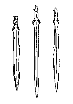

Late Bronze Age- Middle Bronze Swords
The new type of sword was accompanied by "new combat methods implied by the form of the novel leaf-shaped blades" [Brown 1982:4]. These swords could be used either as thrusting weapons, or as slashing weapons as "the point is long and acute enough to be deadly in thrusting while the blade's thickness and the curve of its edge comes in exactly the right place for cutting; the reverse curve, where the edge sweeps towards the hilt, is ideally placed for making a back-handed slash" [Oakeshott: 1960:27]. Thus, this change from rapier to sword reflects a technological adaptation to make sword fighting easier, and the weapon more effective. It is understandable, then, that "the rapid adoption of the sword... does seem to have speedily reduced the role of stabbing weapons to ancillary side arms..." [Needham 1990:251].

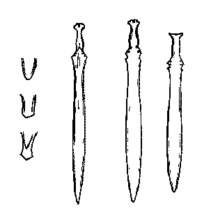

Late Bronze Age- Late Bronze Swords
Celtic Iron Age- Hallstatt Swords
Hallstatt-derived swords are also found in Ireland, where they tend to be quite a bit shorter than the Continental types. These were produced at the same time as locally-derived types, and seem to show little blending with them. One explanation for this is that they might have had different functions, and that "the distinction might simply be that the Hallstatt weapons were for cavalry warfare whereas the Class 4 swords were used by infantry" [Oakeshott 1960:30].

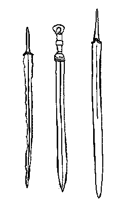

Celtic Iron Age- La Tene Swords
The La Tene swords of Britain were generally thinner than the Continental ones, and those of Ireland are quite short. "This is in sharp contrast with the long swords used by Celtic peoples abroad, and clearly indicates the local character of the Irish weapons" [Raftery 1994:141-2]. The Irish swords more clearly illustrate the development from Hallstatt types, as the earlier ones are leaf-shaped. They then became triangular, and then parallel sided [Ibid.:142].
The style of fighting in which these swords were used is not entirely agreed upon. On the Continent, chariot fighting was very important, so it makes sense to suggest that the very long style of sword in use there enabled a warrior to reach his foe. As in a chariot it "is difficult to do anything with a sword except to slash at your opponent" [Oakeshott 1960:53], it is probably safe to assume that this was how these swords were used. The fact that La Tene blades have a rounded point supports this view. However, regarding the earlier blades, many have midribs and "normally tapered to a sharp point" [de Navarro 1977:131], and may have been used "primarily as thrusting weapons" [Ibid.]. The swords of the British Isles, with their thinner blades and decreased length, may have been primarily infantry weapons, as the smaller size would be of some advantage in close combat.

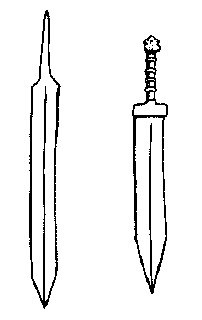

The two main sword weapons of Imperial Rome were the 'spatha' and the 'glaudius'. The glaudius is perhaps the most well known of the two. It was a short sword, with "a double edge and a sharp, strong point" [Weland 1991:34]. It was wide-bladed, and primarily used as a stabbing weapon. This was "the standard infantry weapon of the Roman legions" [Ibid.]. The spatha, on the other hand was a "single-edged weapon... which was longer and was used in the right hand, complemented by the short sword carried in the left hand" [Wilkinson-Latham 1972:8]. This longer swords were usually carried by auxiliary troops [Adkins &Adkins 1983:123], and are a likely ancestor, or at least an influence, on the Anglo-Saxon single-edged long sword [sax], which was sometimes referred to by the same name.
Roman Gladius
One important effect that Roman occupation had on local armourers was the removal of their patrons when indigenous Celtic tribal aristocracy was depressed and placed under Roman rule. The weapon-smiths would not have been totally out of work, however, as "the absorption of sword-smiths into Imperial workshops for the manufacture of auxiliaries' weapons is to be expected" [Piggot 1950:20].
Roman swords were usually made by the process known as pattern welding, a method which was continued into later Saxon times. This was a process of adding layers of soft iron to a medium carbon steel core, welding on twisted carburised strips of iron onto either side, and then welding medium carbon steel cutting edges to the narrow sides [Tylecote 1962:250]. The result was not only a stronger blade, but a very attractive one, and twisting the strips in different ways resulted in different patterns [Ibid.]. Despite its attractive result, pattern welding is primarily a "by-product of the method of manufacture and not an intended effect, although the effect would be of some use in giving the visual proof of the quality of the weapon" [Ibid.].

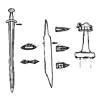

Anglo-Saxon and Viking Swords
typical sword- left; langsax- middle; ring-sword hilt- right
The fuller has often been called a "blood groove" or "blood channel", and was believed to allow the blood of somebody stabbed with it to flow out more readily and thus kill the victim more quickly. I have also seen it quite certainly stated that the actual function of the fuller was to break the suction on your sword after you have stabbed someone without you having to twist the blade [this was in a Chinese martial arts book which I was, unfortunately, unable to find again when I decided to write this paper]. Never having stabbed someone, I have no idea if either of these claims are true. However, many of the blades which have fullers are primarily slashing weapons, so neither of the above ideas seems to make much sense. The best suggestion I have thus far read, and the one which I heartily support, is that the fuller was a means to lighten the blade without losing any of its structural strength, following the same principle of the modern I-beam. In other words: "Its purpose is to strengthen and lighten the blade and has nothing at all to do with blood" [Oakeshott 1960:98], and it functions "to give deeper backing to the edges without extra weight or decrease in flexibility" [Davidson 1962:39].
One type of sword, called a 'ring-sword', which dated to the sixth century, had a ring-shaped attachment in the pommel. In England this usually consisted of a loose ring set into a loop on the pommel, immediately above the upper guard, while Continental types were more elaborate [Ibid.:115]. One possible explanation for this is that two items used for swearing oaths on, the ring and the sword, were combined, and the ring attached to the pommel was for oath-taking [Oakeshott 1960:115 and Davidson 1962:77]. Another possibility is the 'fridbond' or 'peace-strings' mentioned in the sagas. It is speculated that the ring was used for tying the sword into the scabbard so that it could not be hastily or rashly drawn [Ibid.]. Another possibility is that the ring was put on the hilt to commemorate it as a gift, but there is no confirmation of this idea in the literature of the period [Davidson 1962:75]. At any rate "allusions to ringed swords in the literature are few and rather vague, but they confirm the suggestion that such swords were of special value" [Ibid.].
Another kind of sword, perhaps better described as a long knife, was the scramasax [also called sax, or seax]. The term 'scramasax' has generally been used to refer to the whole class of single-edged swords, but these can actually be divided up into "sax (short sword), langsax (one-edged long sword), and scramasax (dagger)" [Davidson 1962:40]. This was a single-edged weapon which "seems to have descended directly from the Greek Kopis", a similarly shaped weapon [Ibid.:117]. They had broad, often curved blades with acute points, and varied considerably in length. The hilt was basically a horn or wood covered extension of the blade. It was originally believed that these swords were not pattern welded [see Tylecote 1962:276], but recent work has shown that to be false [Tylecote & Gilmour 1986]. Scramasaxes were "usually decorated by pattern welding..." [Ibid.:123] which was generally in a lengthwise strip near the back of the blade. Unlike in sword manufacture, pattern welding seems to have been done more for decoration, as most of the blade consisted of an iron core with a steel "jacket" around the entire surface, or with only a steel edge [Ibid.:243]. This type of sword "remained almost unchanged until the end of the Viking period, and survived throughout the Middle Ages as the falchion, and on into modern times under the guise of the sabre" [Oakeshott 1960:59].
Later in the Saxon period, by around the ninth century, pattern-welding was used less and less for swords "probably because better ores were obtainable" [Davidson 1962:32]. However, pattern-welding "continued to be used in scramasaxes or knives for longer" [Tylecote & Gilmour 1986:247]. Because of the availability of better ores, late Saxon blades are often 'plain' [as opposed to pattern-welded; they were often inscribed or inlaid]. These swords were made by a variety of methods, including a 'piled' technique, and one with welded-on edges [Ibid.:247-8]. This change in forging methods was accompanied by a change in shape. Many swords had blades that tapered from hilt to point instead of being parallel for most of their length. They were also better balanced, with the weight closer to the hilt [Davidson 1962:39]. These swords, as those before them, were primarily used as cutting weapons, although they could also have been used for thrusting [Ibid.:39 & 196].
