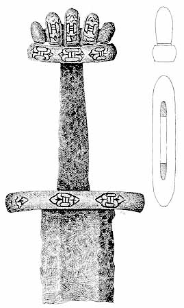

Fig. 104. Berg, Løiten, Hed. 1/2
[Group] I.  (fig.104). I include twelve swords in this group, all with double-edged blades, as far as these are identifiable:

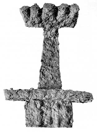

Fig. 105. Gunnarsby, Rygge, Smaal. 1/2
I have referred eight specimens to this type:

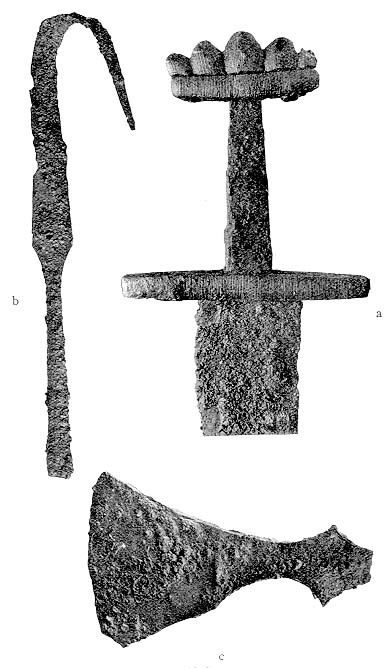

Fig. 106. Kamfjord, Sandeherred, J. L. 1/2
There is a clear kinship between the last group and individual specimens of type K. It might seem artificial to create a distinction based on whether the tongues [on the pommels] are standing straight up or protruding to the sides and if there is a larger or smaller division between the individual tongues. I have nevertheless made a distinction and believe there is a difference in time between these types. The first, which had as its origin swords like T 453 from Gravraak in Melhus (fig. 89), appeared in the first half of the 9th century. It can be found in its further stage of development in the second half of the 9th century, and has most likely developed further in the O-type, which primarily belongs to the 10th century. This is how I view the development, and I shall now use the find-combinations in an attempt to show how I gained this understanding. It is not at all my belief that the development has taken place in this country [Norway] like I argued was the case with the development of the B-type into the C-type. It is also clear that type O is foreign just like type K, at least foreign in its origin. But I think it is evident that there is a connection [129] between the types, a similarity that consists of the five-lobed pommel, separated into five quite uniform tongues.

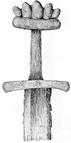

Fig. 107. Saarheim, Gloppen, N. B. a ca. 1/2, b ca. 1/4, c ca. 1/3.

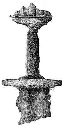

Fig. 108. Seim, Røldal, S. B. Omtr. 2/3
We also have two very interesting swords of this type that show a fusing of the upper guard and pommel, and maybe only a pommel alone used as an upper hilt. These extraordinary swords are B 6718 (fig. 108) and Nordiska Museet, Stockholm nr. 7317. The first is from Seim, Røldal, S.B., and the other from Skeie, Hjartdal, Brb., and as such found in two places that very possibly were connected in older times. This must then again be considered a simplification of the type, such as we saw it in the B- and C-type, in the H-type, in a couple of examples of the K-type and, as we shall hear, most likely in the X-type. [133]
The first of these two swords was found together with two slender high-ridged arrow heads, a circumstance that brings the swords into agreement with the type overall. There is no reason to believe that these two swords are so much younger than the others of type O; we heard that there were swords of type B and C in the same find.
