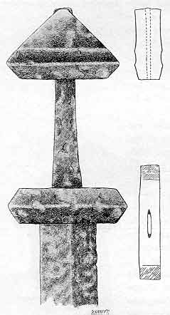

Fig. 57. Alstad, Ø. Slidre, Krist. 1/2 [page 66]
This type developed directly from type B. The upper hilt is massive. It consists of one piece that is five-sided and with a cross section as in type B. Usually it has a uniform thickness throughout, although sometimes it is slightly tapered at the top or bottom. The broadsides of the upper hilt are most often furnished with two horizontal ridges or protruding edges, one in the dividing area between the upper guard and the pommel, and one between the outer corners. On one specimen in the collection from Sandvigen, this edge is an imitation of a pearled band (sl. fig. 64). Of the two ridges, the uppermost ridge is sometimes omitted. The section between these two edges is most often curving inwards, although the older specimens are without this inward curvature, just like in the previous type. It is less common that these ridges are substituted by inlaid forged stripes or protruding moldings that seem to be imitations of twisted or smooth thread that has been inlaid in these stripes. In one single specimen, B 1622, from Sæbø, Vik, Sogn, there are remnants of a metal thread. Finally there exist individual, especially smaller hilts, where the broadsides are entirely smooth. The lower guard is most often ridged with inward curvature between the ridges. It can however have the same inlaid forged stripes or protruding moldings as the upper guard.

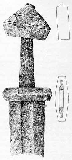

Fig. 58. Vik, Nes, Busk. 1/2. [page 67]
Here in this country, I know the type in 110 specimens. Those swords that have lost their upper hilt, but that nevertheless have a lower hilt belonging to this type or the previous, have not been included among these [110 specimens]. Of this latter group I know 33 specimens, divided among types C and B, but mostly of type C. Of the proper C-type, 67 are single-edged and 40 double-edged. Three were laid down without a blade. It should be noted that damascening never occurs on swords of this type. On the previously mentioned specimen B 1622, there are inscriptions on the blade however, although not with Latin letters but with runes that might very well be Nordic.[2]  Of the 33 specimens without an upper hilt, 21 are single-edged and only 12 double-edged. As we see, this corresponds approximately to the relationship seen with respect to the C-type.
