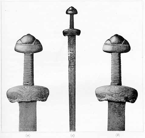

 FIG. 13. THE SWORD CALLED THAT OF ST. STEPHEN," PRESERVED IN THE TREASURY
OF THE CATHEDRAL OF PRAGUE
(a and b) Reverse and obverse views of the hilt; (c) the same sword, giving its general proportions
(page 11)
earlier sword than the four others mentioned, and it might well be a weapon of the XIth or even Xth century. The blade, which has chamfered edge, is considerably worn from cleaning, rendering it now very pliable, which clearly has also obliterated an inscription in large Roman letters, of which there are traces running down its centre. The inscription is now wholly illegible. The short, thick quillons and the deep trilobed pommel are fashioned of ivory, engraved with intertwined dragons and foliage directly under runic influence, strongly suggestive of the sword hilts of Northern Europe of very early date. The wire grip must have been added in the XVIth century. The inventory of the Prague Cathedral Treasury Of 1355 mentions: “Gladius beati Stephani regis Ungarorum, cum manubrio eburneo.” The same notice also appears in the inventories of the years 1368, 1371, and 1387. It has been the theory of late years that the sword was presented to the treasury of St. Veitus by King Charles IV of Germany some time during his reign (1347-1378).

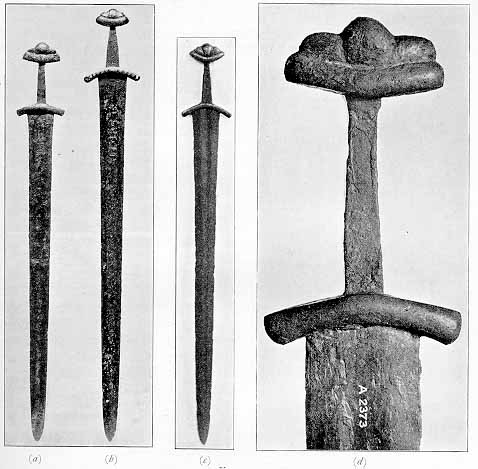

The artist's inaccuracy in matters of proportion we again notice in the absurdly small feet of the same king. However, despite these irregularities, the details of the armaments are accurate. The swords represented have hilts which are almost the counterpart of two swords in the British Museum, a sword in the Collection of Mr. Godfrey Williams, and an example in the London Museum (Fig. 15, a, b, c, d).
 FIG. 15.
(a) SWORD FOUND IN THE THAMES, LONDON (British Museum); (b) SWORD FOUND IN THE RIVER WITHAM (British Museum); (c) SWORD FOUND IN THE THAMES, WESTMINSTER REACH (Collection of Godfrey Williams, Esq.); (d) SWORD FOUND IN THE THAMES, WANDSWORTH REACH (London Museum). The hilt three-quarter scale

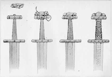

[further reduced in this online edition] (page 13)

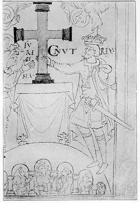

These weapons have the same shaped pommels, but the quillons droop slightly at the ends and lack that accentuated point over the centre of the blade. In the drawing (Fig. 14) the hindmost king has the hilt of his sword so fashioned, though by an artistic licence his sword is not so robust in proportions. The register of Hyde Abbey, written in the early years of the XIth century, shows a slightly different type of hilt, for King Cnut is represented wearing a sword with a three-lobed pommel and thick heavy straight quillons (Fig. 16).
 FIG. 16. KING CNUT
From the register of Hyde Abbey
British Museum

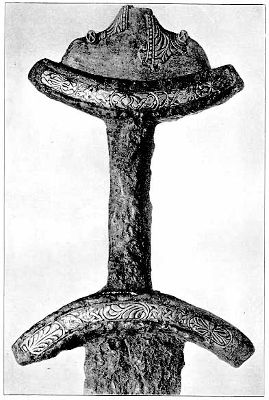

applied to the surface of the pommels and quillons in the manner of the azzimina damascening of the XVIth century, although we can give an illustration of a superb sword hilt found in the Thames at Wallingford about 1875, formerly in the collection of Sir John Evans, but now in the Ashmolean Museum, Oxford, where the decoration is composed of overlaid silver plates chased with figure subjects and scrolls. It has been suggested that in this particular sword the animals upon the pommel represent the emblems of the four
FIG.21. SWORD OVERLAID WITH PANELS OF ENGRAVED SILVER
The date is from about A.D. 900 to 1000. The decoration is under strong Norse influence Ashmolean Museum, Oxford
Evangelists (Fig. 21). Many of these swords, when in their original condition, must have been genuinely beautiful quite apart from any barbaric splendour lent to them by the addition of elaborate scabbards and settings of gems. Most of the hilts which we have illustrated, it will be seen, are English finds, much resembling one another in the principle of their manufacture. They are usually classed together under the heading of the "Viking" type. The blade was forged double edged, the section at the hilt varying a little according to the accentuations of its central grooving. In constructing the sword, the quillons were passed over the tang (the continuation of the blade for the reception of the hilt); these on their underside were deeply grooved in order that they might fit firmly over the extreme top edge of the blade. Next the grip was added: [16] here we must once more conjecture, as no sword of the type, at least those known to the present writer, has been handed down to us with its grip entire, save perhaps for the famous Essen sword to which we shall shortly refer. From the absence of rivet-holes in the tang in the generality of these [17] swords, we may guess that in most cases the grip was passed over the tang of the blade as in the sword grips of later times. A few, however, have the rivet holes by which grip plates were attached, and of these we give an illustration of a reconstructed specimen (Fig. 22). The grips were probably fashioned of wood, bone, horn or ivory; if of wood, they were doubtless covered with leather, though not bound with wire, as at a later date. The foundation wood of the grip, from close examination of the few remains that have been found, appears to have been pine-wood, as do some of the remnants of the foundation wood of the scabbards. On the top of the grip was placed the pommel, the tang of the blade passing through it and being riveted over at the apex.

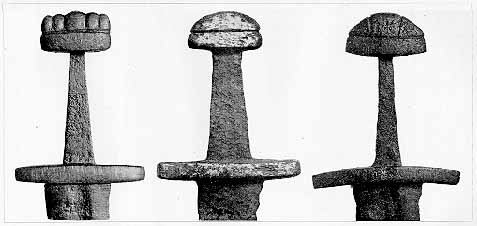

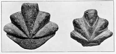

There has been much controversy as to the origin of the shape of the pommel with the five or three lobed ornament. It has been suggested, with some degree of likelihood, that at the time when the flat oval pommel was in fashion, not of the type just illustrated, but about a century and a half anterior to the appearance of the lobed ornament, as, for instance, on such a pommel as shown on the sword hilt (Fig. 23), a mæl dating from the IXth or even VIIIth century, the fighting man used to bind a relic or charm to counteract misfortunes or strengthen his arm, and from this habit the lobed pommel was evolved. Its gradual development might be traced in the manner suggested (Fig. 24) until its latest form is seen in the early years of the XIIIth century (Fig. 25).
 FIG. 24. THE SUGGESTED DEVELOPMENT OF THE LOBATED POMMEL
From a drawing by the present writer
(full page19)
 FIG. 25. THE LATEST DEVELOPMENT OF THE LOBATED POMMEL
Examples in the British Museum; XIIth or Early XIIIth century
(page 20)
This theory, brought forward by a very eminent authority, is strengthened by a careful examination of some of the actual lobated pommels here illustrated and described. In nearly every case the cord by which the relic was originally tied to the flat disk pommel is indicated, and in individual weapons it is represented by its counterpart in metal, either gold or silver. Certain museums of Northern Europe, notably that of Copenhagen, are extremely rich in these so-called Viking swords, though it may be accepted that the [18] ultra-enriched specimens they display are of somewhat earlier date than those British finds we have illustrated.
