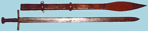

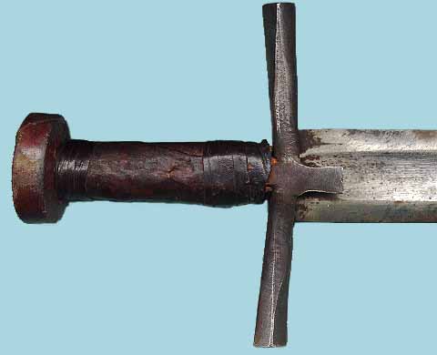

Example 1. A plain "munitions grade" kaskara, most likely of the late 19th Century, having the typical disc pommel mounted in the usual fashion such that the tang passes through the flat faces of the disc. The pommel and grip are wrapped in thin leather over wooden cores. The iron crossguard includes the typical short languets on either side and has a square cross section at the ends, rotated 45 degrees out of the plane of the blade. The double-edged blade is forged and has a single wide fuller running from the guard almost to the spatulate tip. The scabbard is of red brown leather and shows the characteristic distal flare. The scabbard tip is covered by thin sheet iron. Overall length: 102.2 cm. (40.2 inches); blade length: 89.7 cm. (35.3 inches).

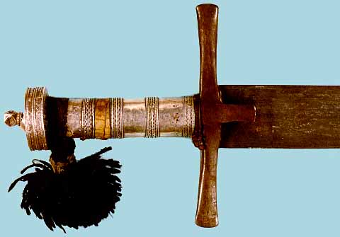

Example 2. A kaskara of the mid to late 20th Century. The hilt is of the characteristic shape and covered in thin German silver or low silver alloy sheet with applied raised trim of the same metal. The core of the hilt is wood. A small band of reptilian skin is also present on the grip. A black wool tassel is affixed to the grip beside the pommel. The forged iron crossguard includes the typical short languets and has flattened tips. The double-edged blade is made of modern sheet steel of uniform thickness, much like a modern machete, having filed edges, but with the quarter of the blade nearest the hilt left entirely unsharpened. The traditional spatulate point has been retained. The brown leather scabbard features various bits of plastic trim. Overall length: 102 cm. (39.7 inches); blade length: 87.3 cm. (34.3 inches).
